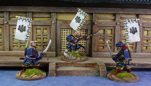

I have made my own decals many times, I recently did these sashimono banners
The only problem I see is if you need white in  the design. If you screen print or use a fancy a printer ou can use white ink but on home computers you cannot. Some designs can be fudged by using white decal paper but only if the design will allow.
If you pay for the decal paper I am willing to have a go.
