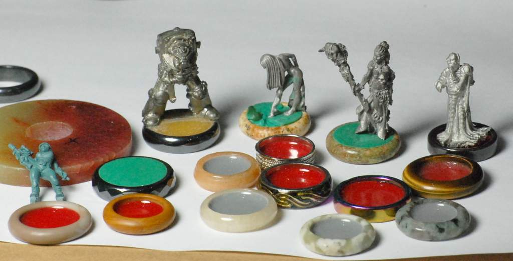

Offline Connectamabob
  • Posts: 1028
Re: Basing solution idea for intregral base figures
« Reply #3 on: August 31, 2014, 10:59:05 PM »
Cheap souvenir rings filled with epoxy (glue, not putty), and topped with Aves/GS groundwork. With tabbed figures I trim the tab down to pegs under the feet so the fig can be mounted cleanly after the groundwork sculpting is done, but for molded-on bases I imbed them like you're describing... minus any trimming to make them fit the rings' diameter or depth, of course.
The ring adds strength and weight, and gives the base a nice looking display-like rim.
Epoxy glue still needs to be mixed, but it can be had at a wide variety of stores (even supermarkets), and it is a resin, so you can fill stuff with it and even cast with it.
Which reminds me, I really need to to get some new stuff off the bench. That pic is not as compelling as fully finished/painted minis would be.
« Last Edit: August 31, 2014, 11:06:02 PM by Connectamabob »

« Reply #6 on: September 01, 2014, 10:58:53 AM »
Much simpler and safer than trying to cast the models into the bases.
This. If you're working with something like a hollow cast base or the rings like I use, it's much, much easier to properly control the depth and orientation of the figure relative to the base. On my first goes with the rings I was just pouring 5-minute epoxy into the ring, sticking the figure base/tab in where/how I wanted it, and holding it there till it set up. I quickly found that way can lead to a lot of errors, like the feet being a smidge too high/low, or the figure leaning slightly in one direction or another. By just capping the bottoms of the rings with the epoxy, then either pegging the figure in place post-groundwork, or using half-cured putty to "blu-tack" the figure in place pre-groundwork gave me far better control and reliability.
