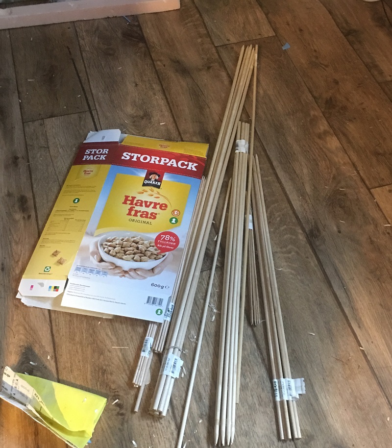

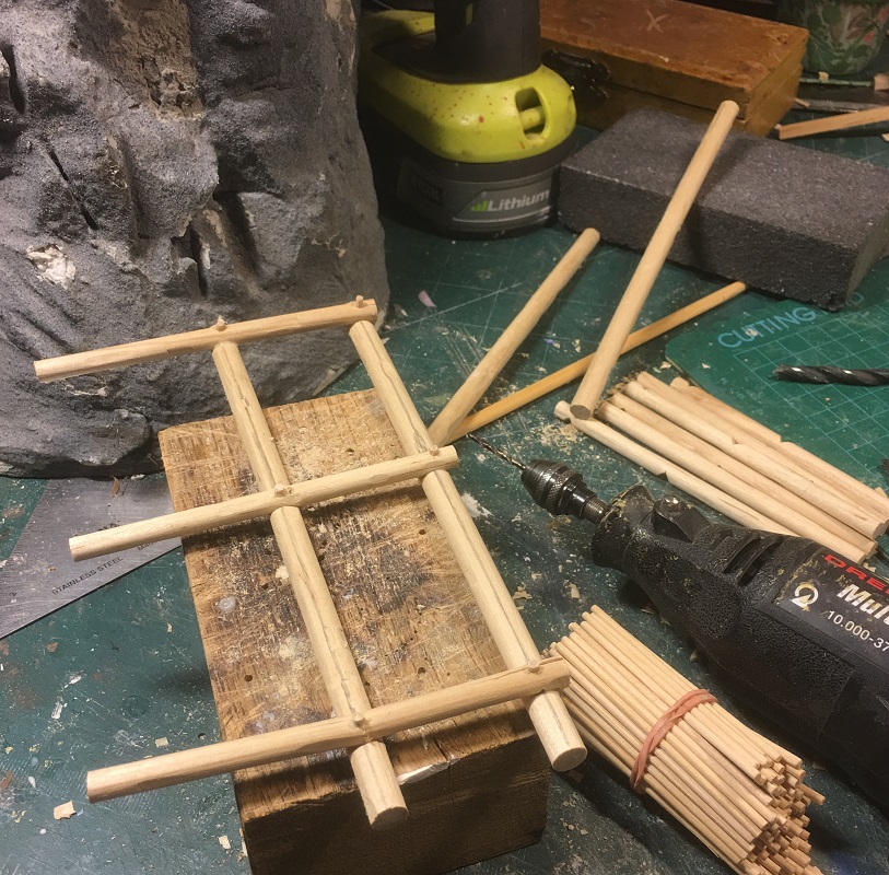

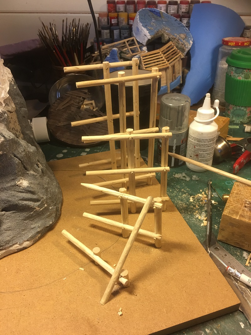

Progress report.
I went to the garden shop to score some material for the entrance stair structure. Dovels there come in many dimensions at a fraction of the cost the charge in hobby stores.
The dovels are scored, notched and sanded with course sand paper along their length before I cut them.
The larger frames are fit in with a rather authentic metod plus carpenters clue. I use real wooden dovels for that real carpentry look.
I have pinned the larger frames to a MDF baseboard. As I don't cut all lumber beforehand, this makes it easier to cut the various beams and supports individually to the right length and angle. Once completed the whole structured will be heavily weathered and partly broken up. I find this easier to do to a intact structure rather than as it is put together.
