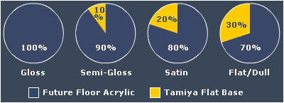

My experiment was to see if I could achieve a clear flat coat by applying this Flat Agent, mixed and thinned with distilled water.
distilled water is the problem.
use Klear/Future as the medium

If you wanna go Brush-On then Daler-Rowney Soluble Matt Varnish is a great product.
Thank you for the little pie charts, redzed. That was interesting.
