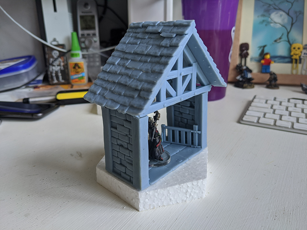

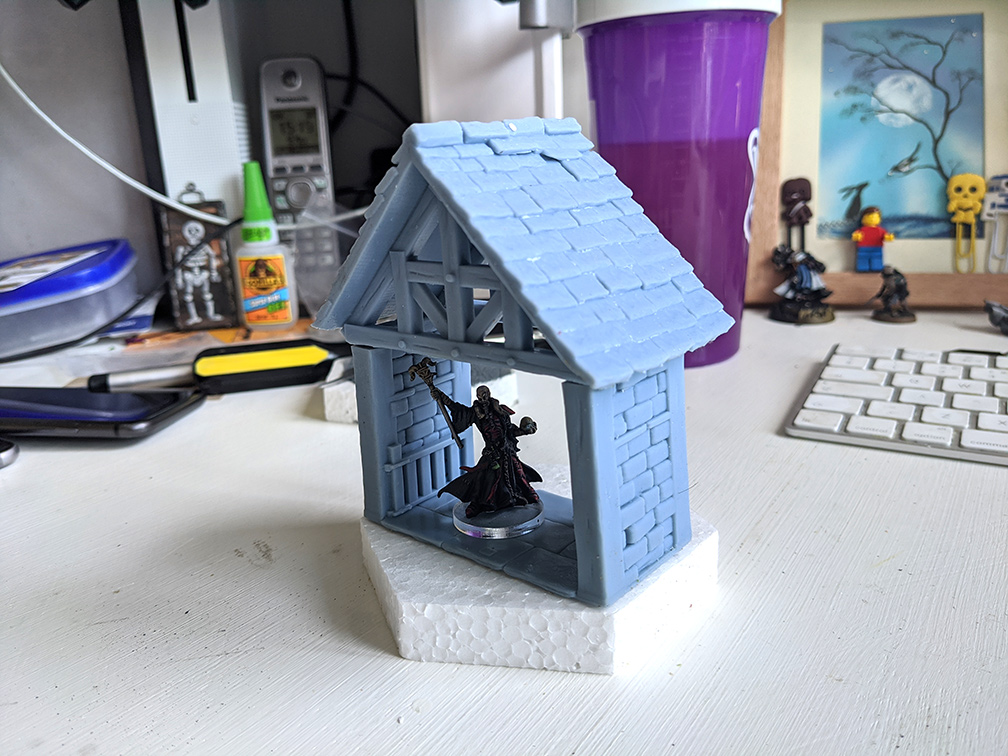

Not much progress on the actual board this weekend, other than slicing a load more hexes and edge pieces while the printer was working its merry way through the Lychgate parts and an archway for the graveyard wall.
The Lychgate is being modelled here by our resident necromancer, Bob. You can see his nice halloween style accents the graveyard beautifully...
The roof is a separate model as I didn't want to have to wait 10 hours to see if the print failed. I probably could have saved time by printing it all as one piece, but having it in 2 makes it a little easier to paint as getting in under that roof would be a pain.  I'm still slightly confused by the gate height though. In Blender the bottom bar is sitting above the floor, but as you can see from the photos, the bottom hinge and crossbar are embedded in the floor... if I ever get around to releasing the models for public consumption, I'll need to go back and look at that again. If.
As for the archway, this is the first time this has actually printed out properly. I suspect adding a new flat plate to the bottom covered up some rogue pixels that were causing it to fail... to I may do that to all the items in future, just to make sure. On the left you can see the new archway with it's wooden door. On the right, you can see an earlier print of the archway all cut up and turned to rubble. This was printed a while back and accidentally broken at the archway as there wasn't the door there to strengthen it. The old one was also a few mm too wide for the base, so this helped bring it back into the hex so that it sits nicely with the other walls.

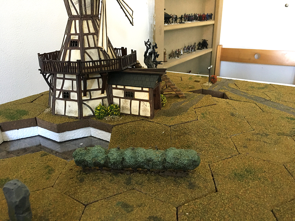

Today's update is hills.
The template set includes pieces to make various hill slopes. I've tried these in the past with poor results, but I gave it another try yesterday and, with a bit of polyfiller as a skim over the top, they actually worked this time! On the table they look really nice, providing a rise in the terrain... but you can't really see it in this photo unless you're looking hard for it behind the Mantic hedge. I've removed two segments to show that the windmill really is one level higher than the base. I spent lunch cutting some more hill pieces and sticking gravel to them to make it a bit more obvious they are hills...  it will be nice to make it a bit less flat. Sadly there's quite a bit of waste material cutting these out... but not enough to be of use in other tiles. The intention is to make enough hill pieces to raise the windmill up another layer or two so there can be some cliffs added to the board as well... that will eventually lead to a mine entrance. One step at a time!

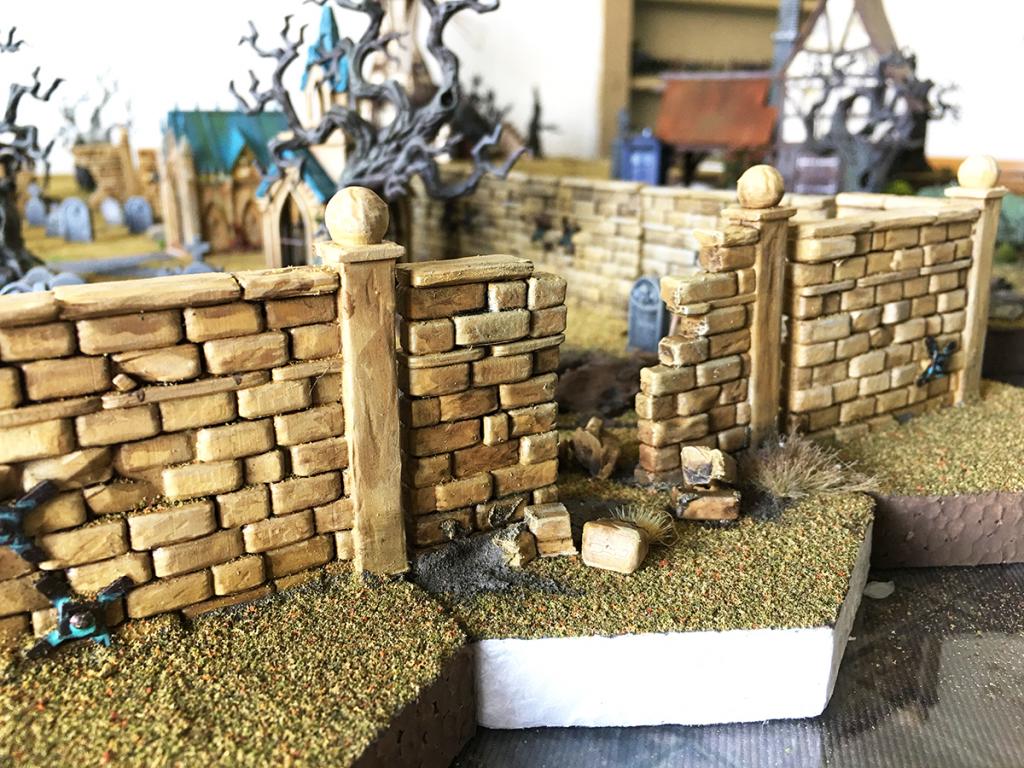

On the plus side, this morning I did manage to finish painting/flocking the lychgate, some more walls, the side gate and four more sets of graves. For now, the graveyard can be considered complete! At least until I decide to print some more graves or wall variations... This is double the size it was originally intended to be, I just kept on filling spare space on the build plate with more graves or walls... oops! Unfortunately I clearly wasn't paying attention at 4am when I painted the new walls as they are a slightly different colour to the rest of the brickwork *face/palm*
I'm pleased that the grain on the gate is visible at this scale. I thought it was too faint when I printed it, or that paint would fill it all... but lo and behold. Washes pick it out nicely
I also had an earlier version of the archway without the door that got broken... so I broke it some more to create a ruined archway
