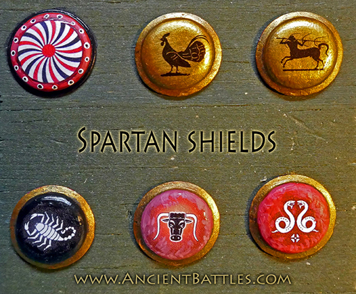

The decals as printed (below), colors are imbedded in. It doesn't have to be that way, but I often make color variants to "fill out" the sheets
The ones which are not black on bronze are painted white first. Some edge cleaning and over painting was done once finished. For example chips and damage are painted on because it seems a waste to have that embedded in the design. I think it is better to have them be clean (in case later on I will reuse them) than to dirty them up.
