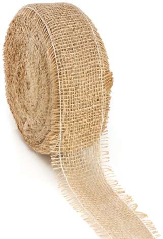

For a "true" rope bridge a friend suggested to use jute ribbon like this, perhaps with some of the threads removed, and with wire "ropes" on the edges. But we didn't try it yet.

Hey Patrice, the  jute ribbon is a cool find thanks, I can see it being used for camo netting straight away!

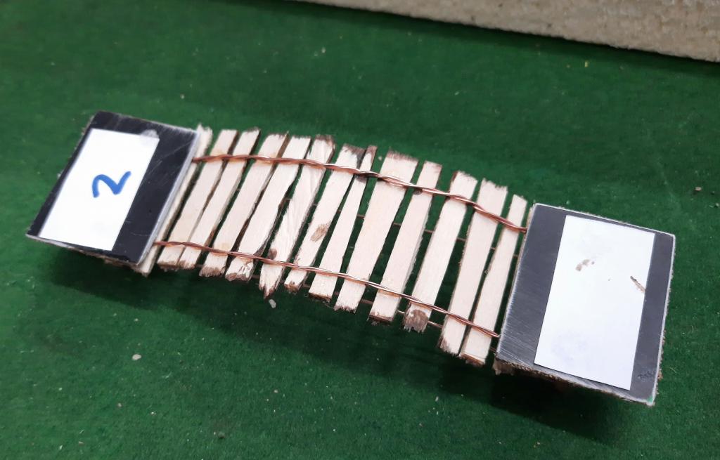

I picked up miniature picket fencing from Michael’s that was already tied with metal wires.  Just square the ends, clip to length, and paint/wash as desired. I also used galvanized nails as end posts so they could be attached using magnets. Outlined in my entry for last year’s BSC.
Not my idea but can’t remember where i saw the original.
