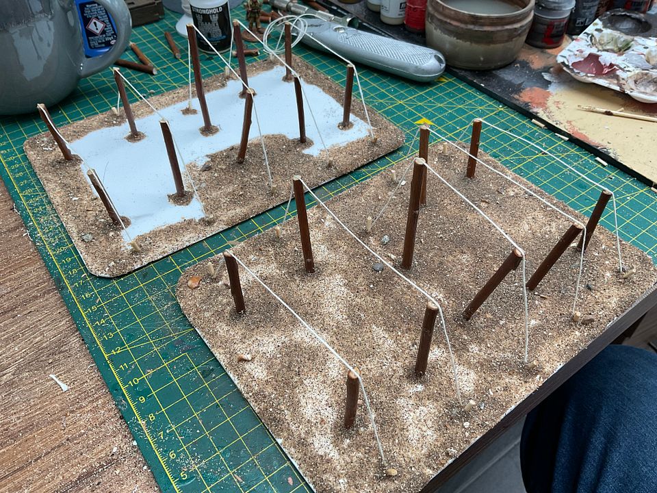

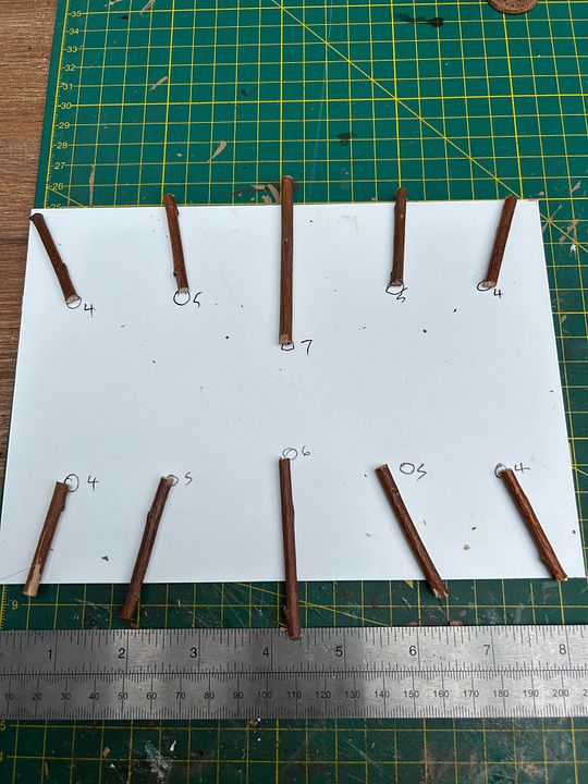

Accepting Snitchy’s challenge, I will have a go at Bedouin Tents.   I’m making these more heroic scale so reduce sizes if you want smaller……but I think these fellas are pretty sociable types and the size of their tent reflects that.   Certainly the one I went in when I was a child was huge….but then I was only half the height I am now! Lol

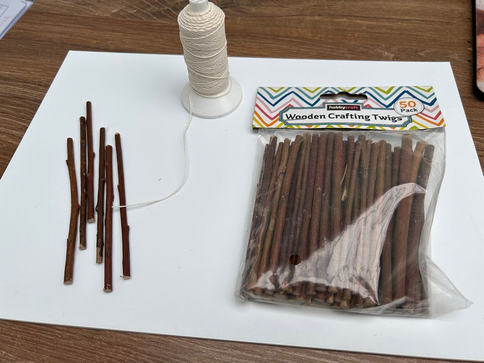

So, looking what I have…..this is the key.
One sheet A4 sheet of plasticard
One bag of wood crafting twigs
And most importantly, wax covered thread ( very strong - great stuff)

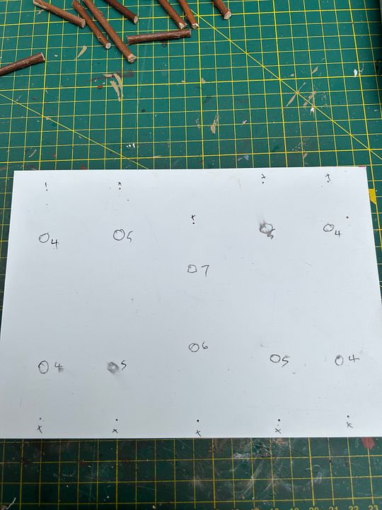

Now…without the use of rulers…ie doing it all by eye…..cut the sheet in half.  Cut a number of poles…..4 at 4cm, 4 at 5cm, 1 at 6 cm and 1 at 7cm.  Mark out like this.

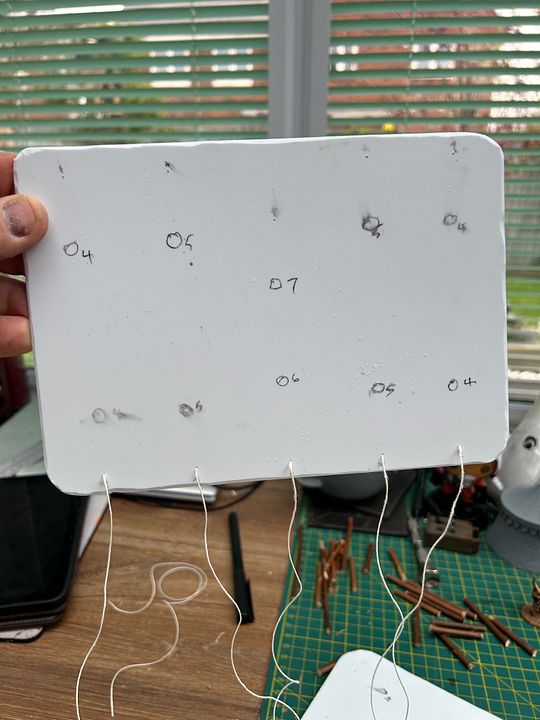

With pin drill….make holes like this
Cut foot long pieces of thread, tie knots in one end and thread like this

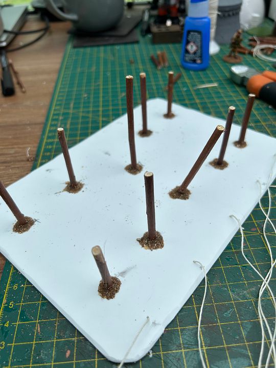

Now using superglue…..glue poles like this….make sure centre front pole is leaning forwards.  I pour and glue a little sand at the bases for strength.

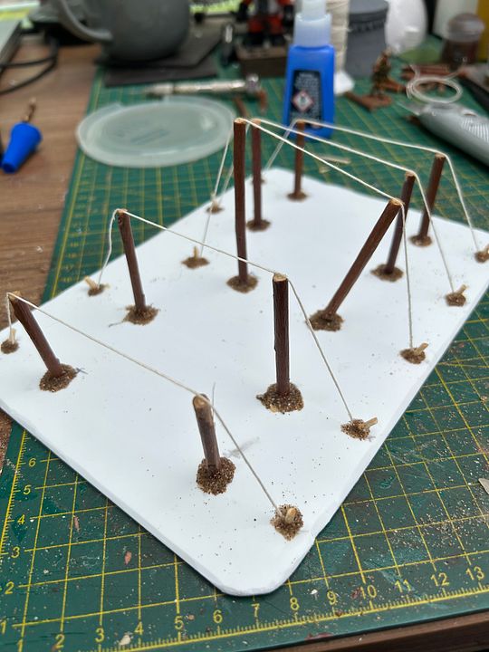

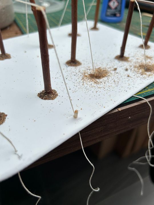

Now, put blobs of glue on tops of poles and lay thread over, threading down though opposite holes.  I then cut little pieces of cocktail stick to look like tent pegs….glue and sand them wher3 the strings disappear into the plasticard.
Should look like this
Now as I’m making an open one and a closed one, sand the bases accordingly.
To be continued…..
