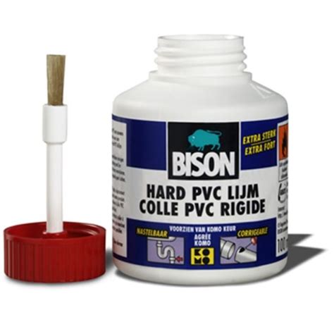

But I never had many issues with the glue itself. It's gloopy, but the glueing itself went rather easy. It was this (Dutch) stuff:
I mist say that a couple of months later the rest of the glue in the container had become a dried ball of gunk. But at least I did manage to glue the stuff from the Kickstarter!
