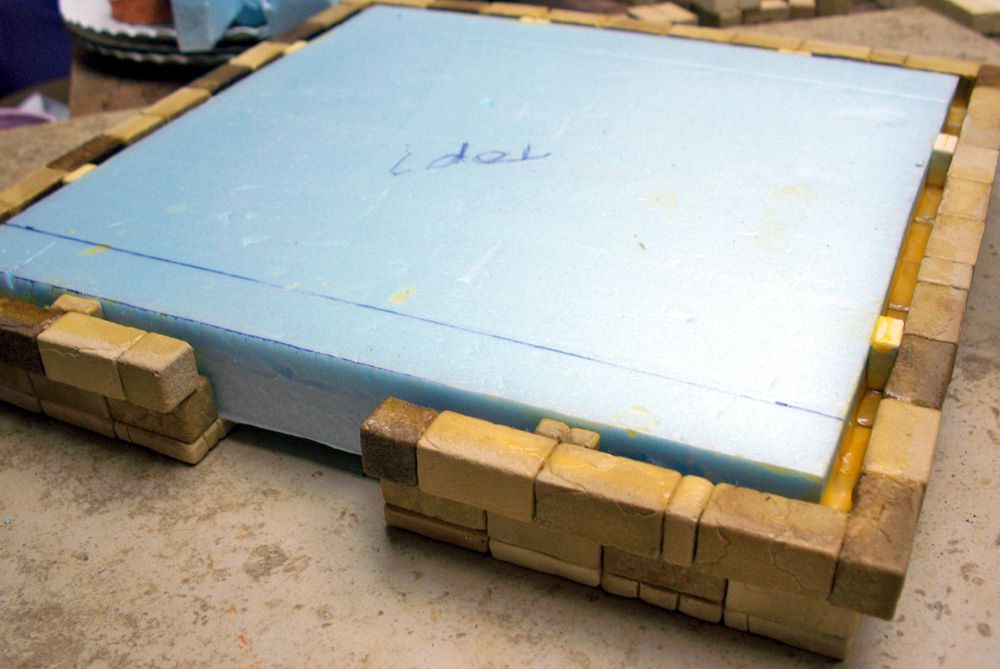

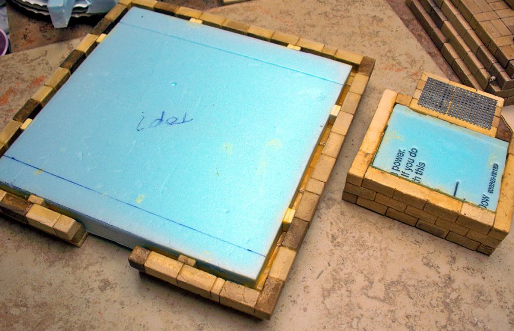

With the temple design, how much that is hidden of the levels is mold pieces. Can we get a look see of the temple's underneath please?
Prof, the quick answer is - "As few as possible." Basically, I try to avoid using molded blocks where they will not be visible. - but I'll get you some pics too.
Here're some pics of a couple pieces. I try to avoid using molded block for anything that isn't visible...
The piece on the left isn't finished yet... (top view)
Bottom view shows the blue styrofoam used to support the floor...

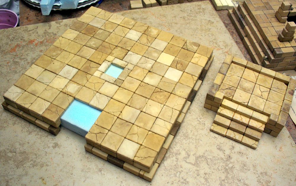

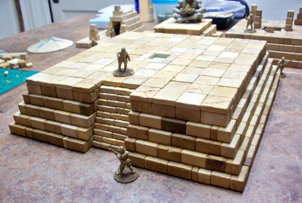

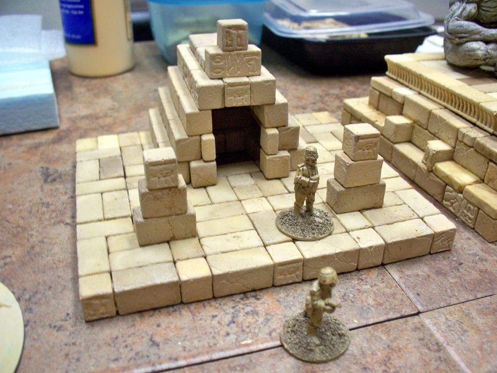

More Hirst blocks madness...
I just finished constructing this piece for our ruined city set. It can be used on its own or as a base for another piece…
Mila made this cool temple piece…
I made this piece to be used as a stand-alone tomb or added to the top of other pieces…
I kept the designs very simple, so the hardest thing about this is molding a couple hundred blocks…

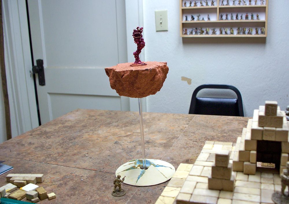

And then there’s this thing…
More to come….

I especially like the flying rock piece.
After reading through Perilous Island in all of its entirety, I think I know exactly what (i.e. who) that thing is.  ;)
