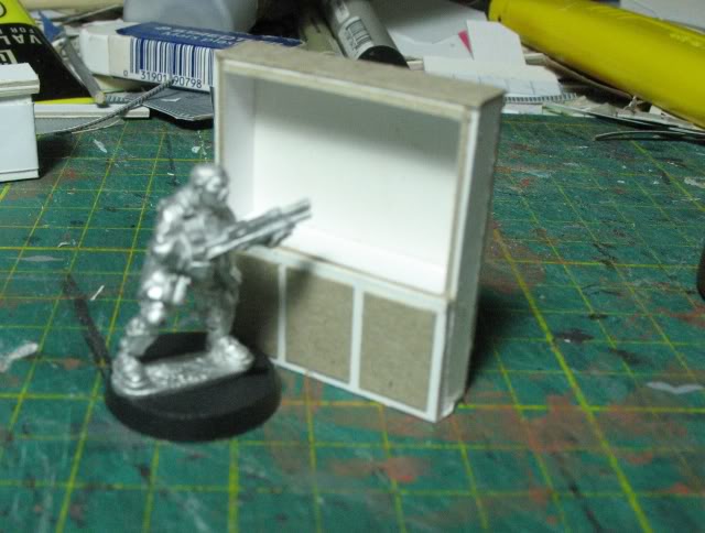

A basic cabinet built...could be used for buffet or with extra shelves as a bookcase also.

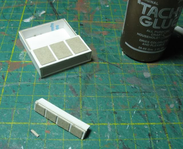

Don't like the look of edges on top of the locker so cut out a top panel with cereal card to cover the joint edges. Tip:I use the locker itself to measure the dimensions.
Cut out some panels from cereal card and glue in place.
There's the basic cabinet

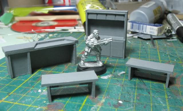

I don't quite like the look so decide to add a top row of bins. Just a couple of strips of illustration board and some card. I often change design as I'm building if it doesn't look right. Easy peasy.
Built the locker, a desk and two cots in about an hour (including photo shoots) and all it cut offs of board.
And painted with a base coat.
Next detailing:
Tip: you can sand the edges of illustration board with fine grit sandpaper to remove imperfections but sanding the top or bottom just produces a rough surface

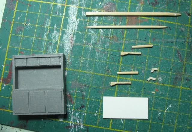

Didn't have/couldn't find spare weapons bits for the weapons rack, so...   a few toothpicks (square and round type) and some cereal card trimmed a bit into the right shapes (two foot rule) and a back panel for the rack
Cut and mount the pieces on the illustration board. Having a separate panel that will fit into the cabinet back makes it much easier to assemble, paint and detail.

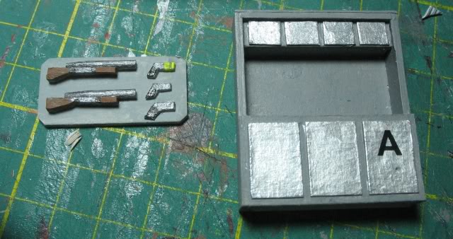

Paint the panels silver/aluminum, and the weapons gun metal, brown and black (and yellow on the Taser), a Lettraset rub on letter, and pigma marker handles.
Completed weapons locker (less the digital combination lock pad still to add) All from scrap.
