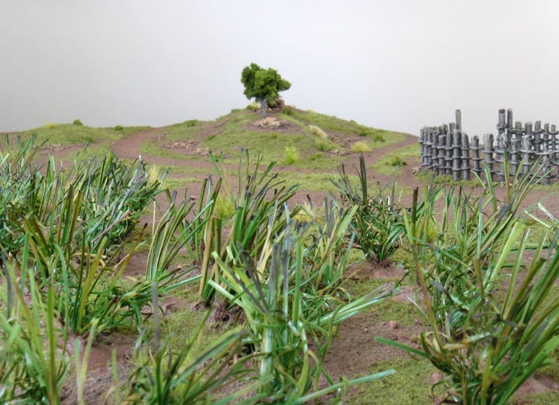

OK I tried doing a test piece now... I mixed up some different kinds of stuff and put i on using watered down glue.
I still think it looks a bit dull...
Any ideas for improvement?
More of this?! Less of that?

That looks really good. If I was forced to think of different things you could do I imagine you could just break it up a bit with some different lengths of grass, perhaps a rocky patch here or there, but really it looks good to me as is. A tree would look cool in there, especially with the larger litter debris you have mixed in the grass. Also some foilage growing up the ruin and in its cracks and whatnot could be nice. But like I said, I think you conquered foilage for the most part.

That does look good. I would say that it needs to be a bit more random, the flower bushes and rock are too regularly spaced and I think some very slight bare patches to show the ground work underneath  :)
Oh, loose the building, I never did like those GW ones  :D

Good grief young Thorbjørn, that looks fine. Really jolly - although I'm not a great fan of all those little coloured bits. I look at the grass in my garden and the fields around, and mostly I just see a pretty uniform green, not lots of little red or yellow bits. Unless you're specifically going for a wildflower meadow - and I think I'd approach that somewhat differently....
I concur with most of the advice given above - I drybrush neat PVA onto the ground surface, then hand scatter a mix of Woodland Scenics turf. I generally try to use a mix of 2 or three textures / grades - fine and medium at least - but stick to one colour. I generally mix in a bit of static grass with the 'turf' too.
Having applied my first layer of grass mix, I then tap off the excess and seal with a sprayed misting of 'scenic cement'. I'm pretty sure this is just watered down PVA, sold very expensively by those clever folk at WS...
This more or less seals the first fix of grass - although if you dab more PVA on top, yes, it will lift in places, so you have to be careful and patient. But it should let you add further layers where it's a bit thin, or to add new patches where you didn't grass in the first place.
Once the grass is down more or less to my satisfaction, I add 'scrubby bits' (don't know if that makes sense in Danish  ;)) - little bits of clump foliage / furze, sprigs of lichen and the all important grass tufts - again in colours which tone in with your grass and bare groundwork. Each piece is glued on with a dab of superglue, and yes, that does take a long time, but I think it's this level of detailed secondary dressing (along with pools, rocky outcrops, twigs for fallen logs etc) which adds the visual interest and sets good scenery apart from mere flock grass.
Then give the whole lot another spray over with said 'scenic cement'.
But do be aware that the scenic cement not only helps all your scenic materials stay in place, but it does also darken them down a couple of notches when they dry.
