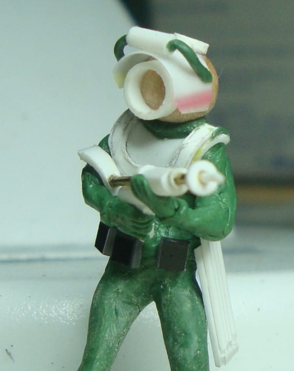

« Reply #2 on: January 12, 2011, 05:19:40 PM »
Have you thought about totally replacing the heads with beads?
Like this

Froggy the Great: that's pretty simple but effective - I was thinking of a similar mix of those with their masks on, and some with it dangling from straps round their necks, and yours certainly look good. Have you posted them before? I don't remember seeing them, if I had I probably wouldn't be panicking now! I can certainly imagine my marines with something like your version. Perhaps a tube and a single 'brass lung' would do.
Gamer Mac: I have considered a complete head replacement, I've been rummaging through my bits box and found a few things that might make good helmet parts. One thing I thought might be suitable was the searchlight lenses from GW kits - they're a circular, convex shape with a grille over them. I thought they might make a good faceplate for a 'diving bell' type helmet. However, I only have a few (3 I think). Getting more parts would have me back in 'getting a load of heads' territory, which I'm trying to avoid (I need at least 10, possibly 20, for my Aetherines). When I make some Aquanauts, however, they're at the top of the queue of parts!
