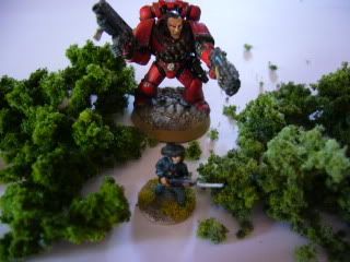

A mate and myself made ground foam using the tutorial on this website.
http://www.2guyz.info/Content/pid=10.html
It was very messy and very hard on the blender and I wouldn't do it again. Even so, it was an interesting project.
Here's a photo of the end result.
Woodland Scenics on the left, homemade ground foam on the right.
Barry
