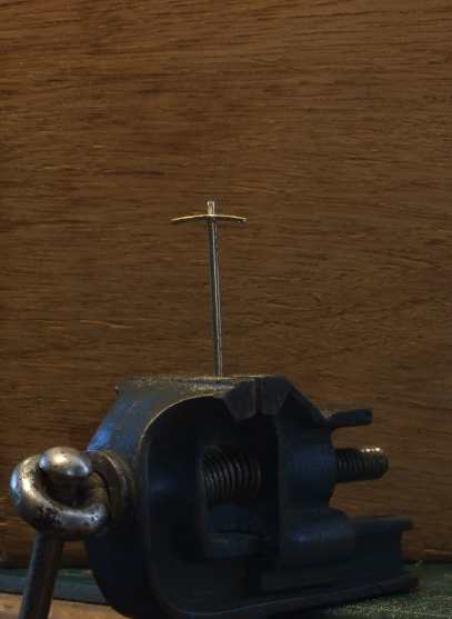

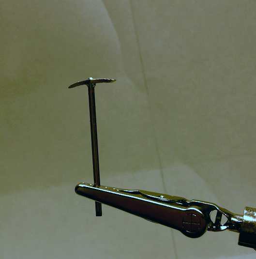

This is the 'raw' shape of a pick axe. It is basically a piece of thickish brass sheet. Roughly cut to shape with metal shears. A hole was drilled in the middle (0,8 mm). A length of 1,20mm brass rod was selected and the end filed to fit the hole where after they were soldered together.
The head was carefully filed to shape with various needle files and Dremel attachments. The files were the more useful items in this case, the Dremel is better for grinding  away amounts of brass and/or polishing. A narrow beak in one end and a broadish, flat edge in the other. The handle was filed to a more oval cross cut shape with a knobbish bottom end, just the way a real pickaxe handle looks.

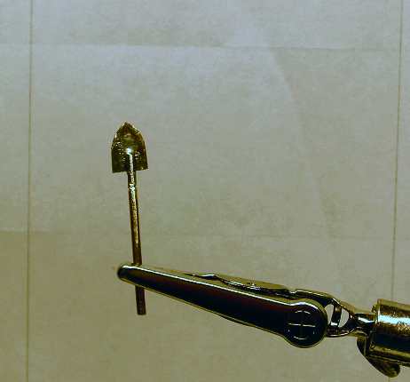

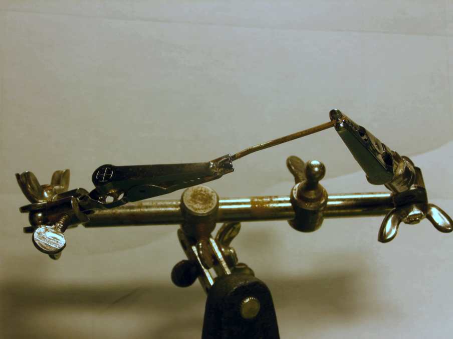

For the spade a rectangular piece of sheet metal was cut out. A 1.20 mm rod of brass rod was bent to a slight kink at the end and the end ground filed to an narrow angle where the handle was to be soldered to the blade. Solder was melted onto the blade and clamped together with  the handle. An extra hands anvil is essential in this job since you basically need four hands to hold solder, iron, blade and handle all together.
The blade of the spade was filed to shape and the edges thinned just enough to look convincing.

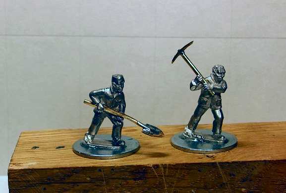

Here are the items in the calloused hands of a couple of convicts.
Why did I go through all this trouble when the miniatures comes provided with cast glue on tools? Well, those flimsy things don't last very long neither on the game table nor (even less so) in storage. There may of course  be other reasons for doing so...

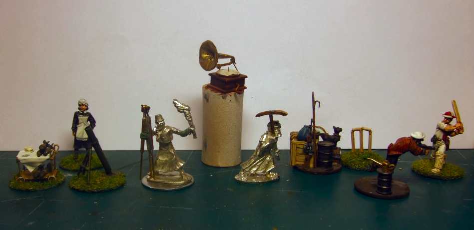

Just another quick and dirth of some other stuff I have done with solder and and brass.
Left to right:
Tea trolly and Stokes mortar ( a bit simplistic), theodolite for Egyptian dig conversion, horn for a Phonograph, pickaxe, boat hook, Cricket wicket, oil can.
EDIT: I admit, they are a bit old hat since I have posted them on LAF before (the theodolite I think not). I have never posted all of them together before.
