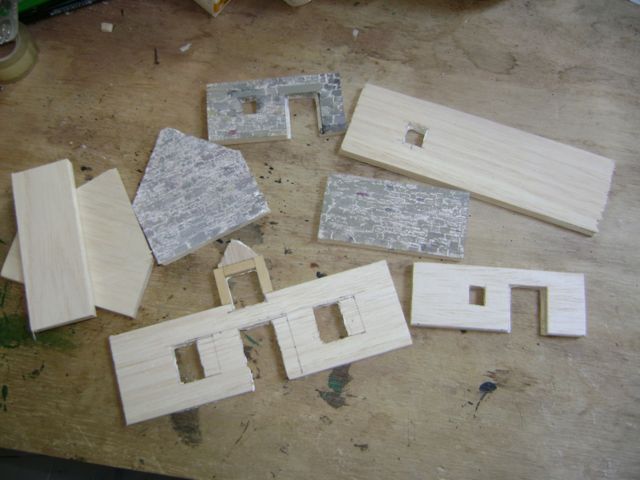

I started this work some months ago and I don't think I have shared it here  :-I
Progress was slow since I began but now I am working on it again. The idea was that, as it was quite difficult for me to understand architecture of foreign buildings, I could get better inspiration from local houses that I can see everyday here in the central Brittany countryside where I live.
So I began to make some houses that could fit in almost any historical local context since the 18th and 19th centuries till today. I plan to do some WW2 skirmish with them later but they also could fit in an 18th century skirmish or in a 19th century horror scenario.
Chimneys are hollow and could work - if it was not balsa wood! lol

That stonework looks great, especially the colour of it - most of us use much less subtle shades of grey when attempting stonework!
Is the stonework carved or just painted on? I can't tell from the photos.

Colour shades are what can be seen on old houses around here, which are built from grey granite (which can have slightly different shades in grey-blue-brown, a few are a bit pink), and some very thick slates to fill the gaps, and probably a few other stones.
I used balsa with some layers of "enduit de rebouchage acrylique" ("acrylic spackle" is it?) and when it was dry I quickly flattened it with a large file (a file for metal, not for wood). Then I carved it (but not deeply) with a sharp pencil, it goes fast this acrylic stuff is soft enough.
I was thinking about a darker wash to fill the carvings between the stones, but after more thought I won't do it, because traditionally the stuff that was put between the stones (before modern cement) is a mixture of lime and sand, its true colour is a very light yellow-grey, lighter than the stones.
Well I still don't know how all this will look when finished, we shall see... ???
