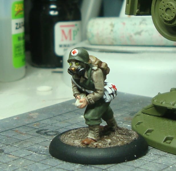

The other weekend I bought my brother the SOTR rules for his Birthday.
I also bought myself a US starter box. During the week I ordered some armoured support.
First painted figure
We are going to do winter games. So I need help on how to do winter bases?
I was thinking of going cheap and cheerful and just using some poly filler. Has anybody any experience of this or of a better way?

Lovely paint job on the medic.  :-*
He looks great. I'm looking forward to seeing more.

Fantastic Colin!! :o
That medic looks great! I love the green lenses and red cross the most!

« Reply #11 on: 12 May 2012, 10:41:27 PM »
Lovely painting Colin, it's good to see that it didn't take you long to get started on the boxset.
Also why am I not surprised that you also bought a mech! I take it your brother hasn't yet. What are the rules like? Fast and fun? Is there much scope for a 3 way game within the rules? And what scale is the combat- skirmish or all out war?
