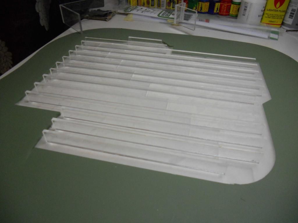

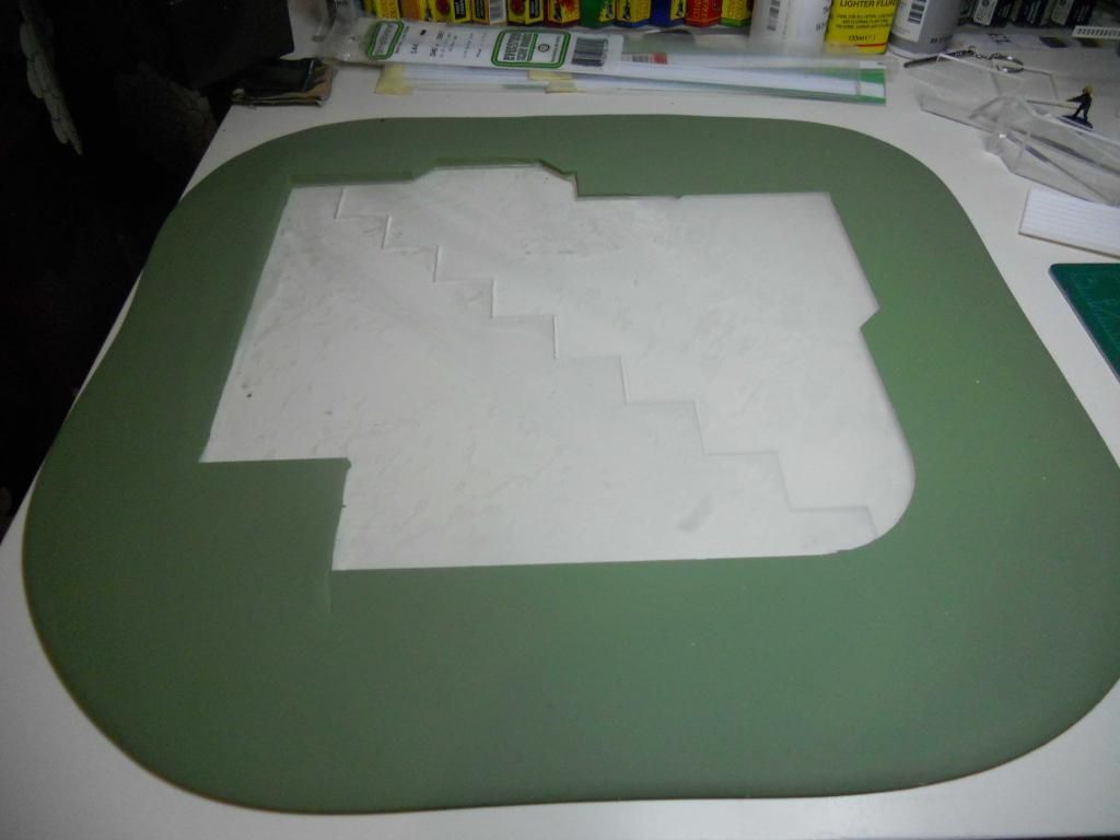

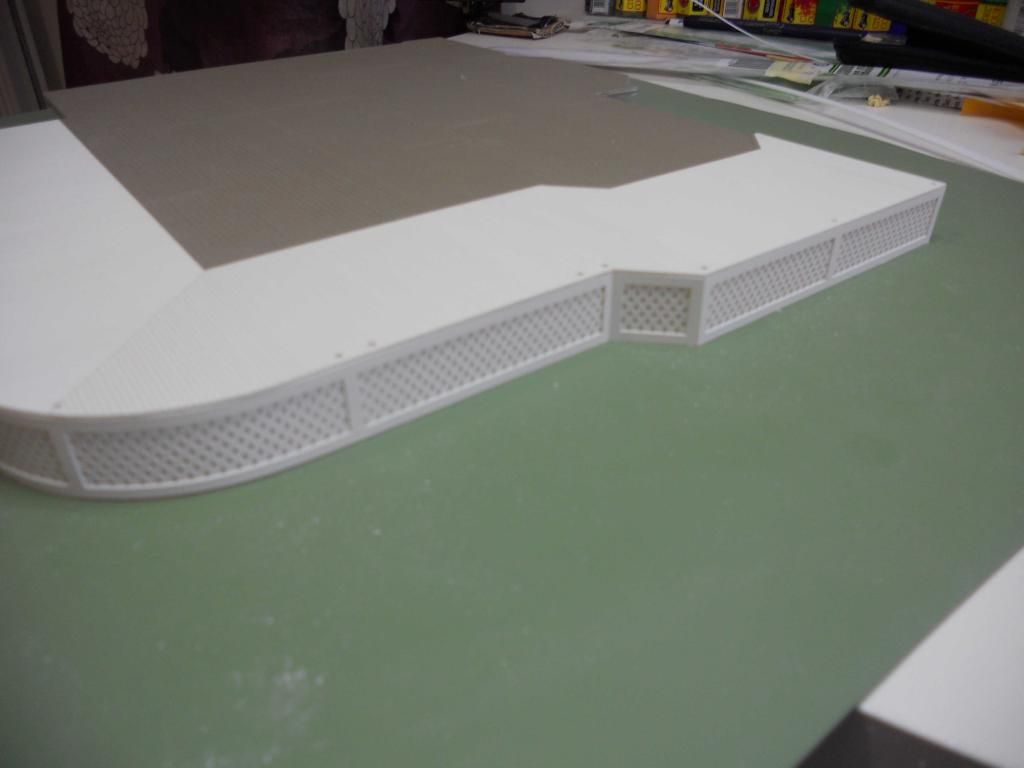

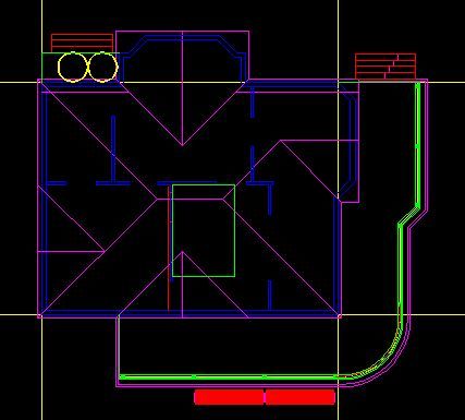

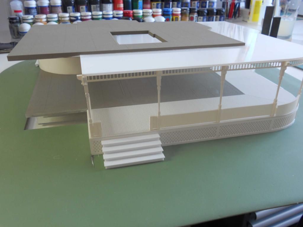

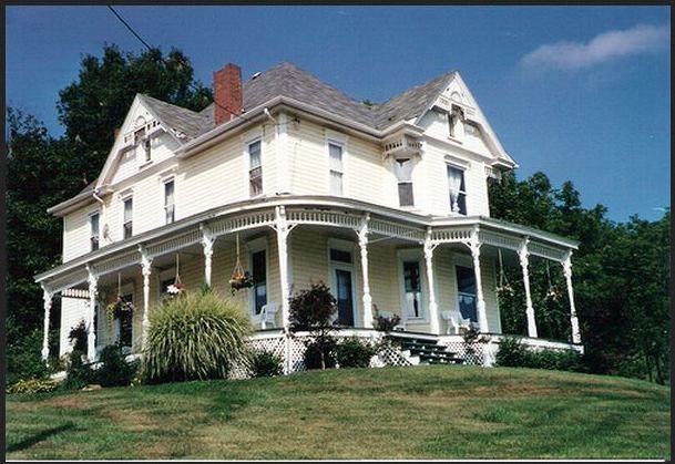

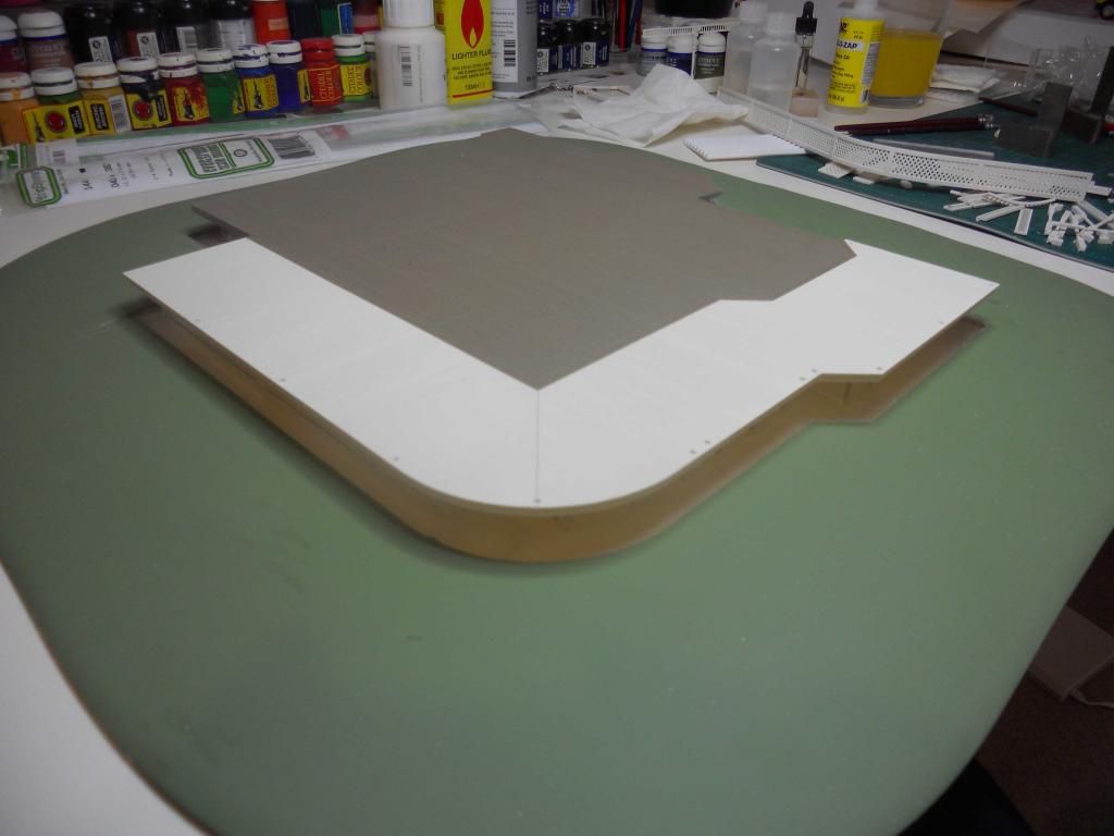

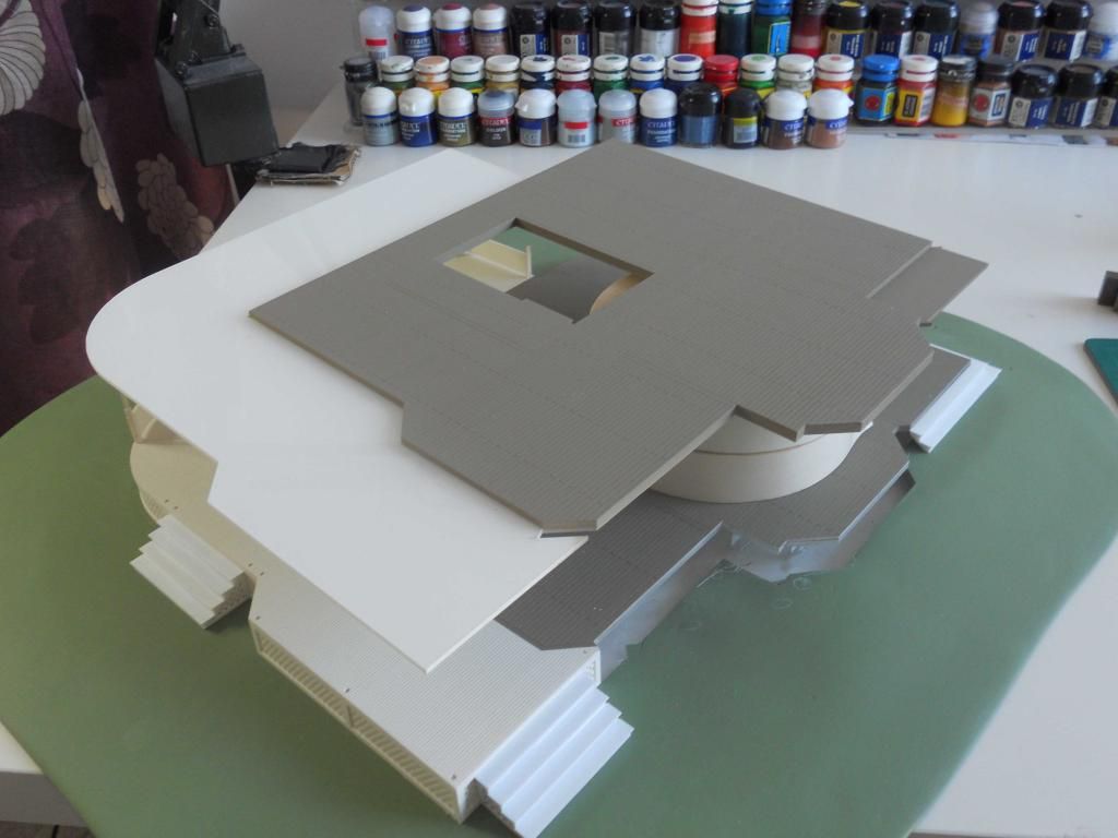

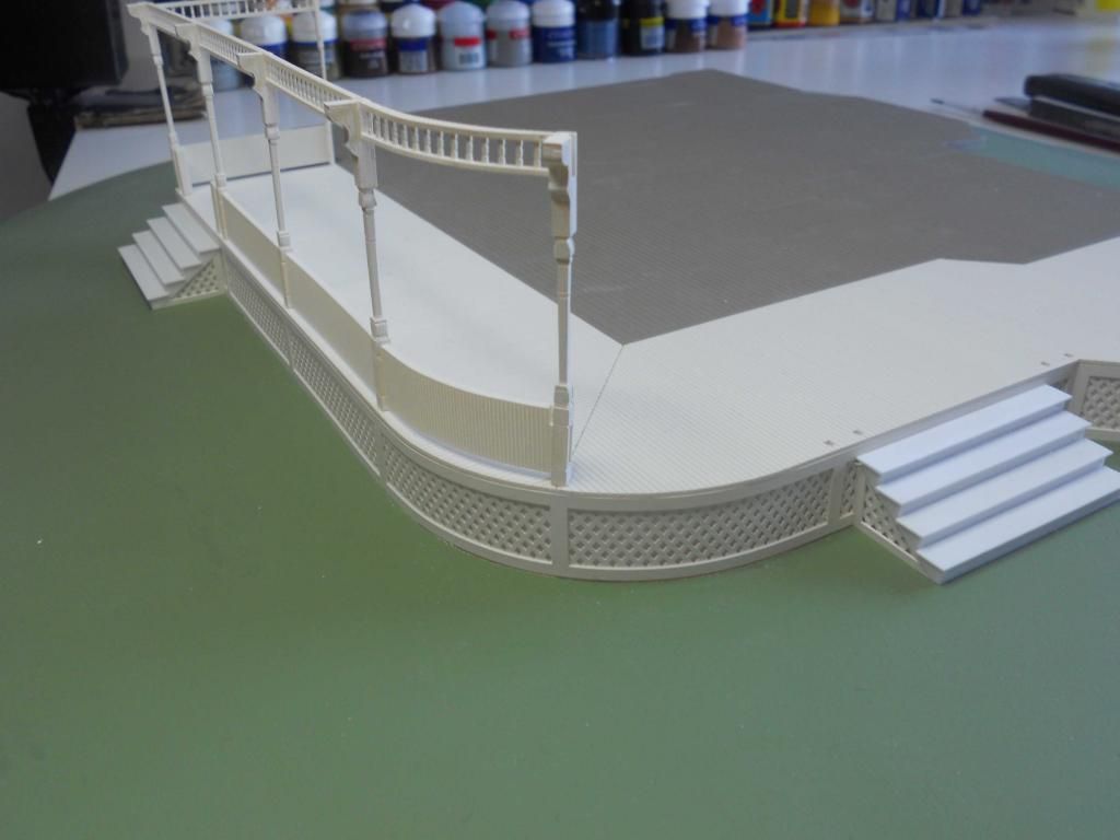

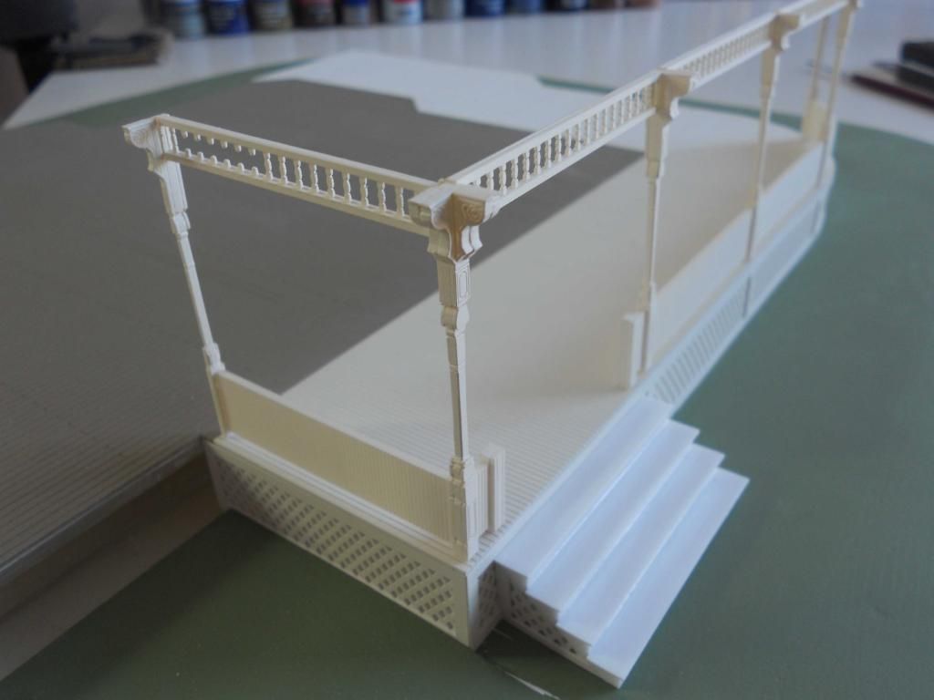

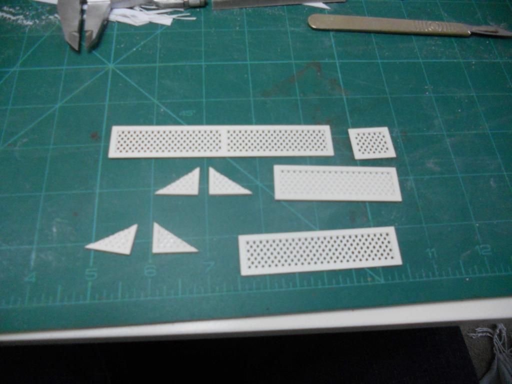

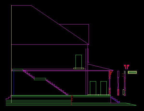

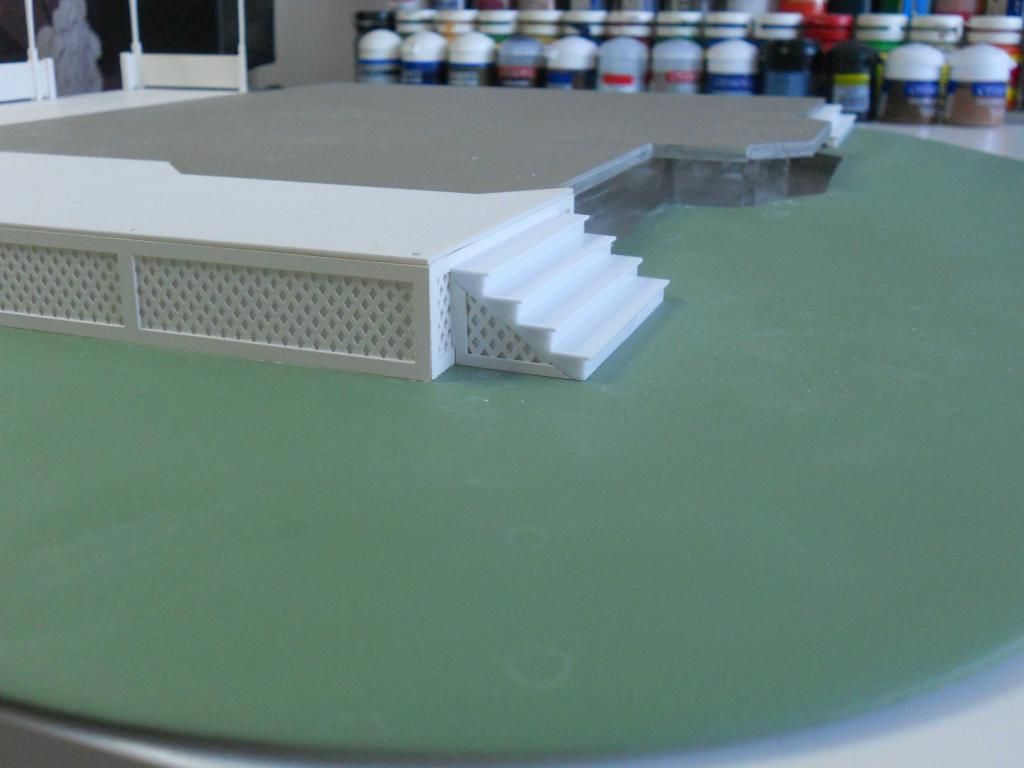

Hi all,
I started drawing up plans a few weeks ago to build the farmhouse from the Night of the living dead 1990 remake. It will hopefully be the centre piece of a modular gaming board i'm planning on putting together, which at some stage will also include the barn, outhouse/shed and gas pump.
Still in the early stages, but the plan is to have a removable roof and first floor.

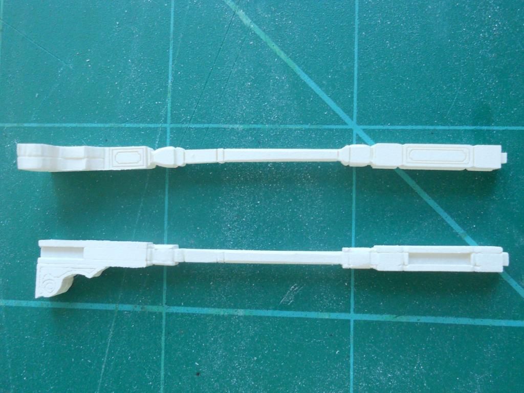

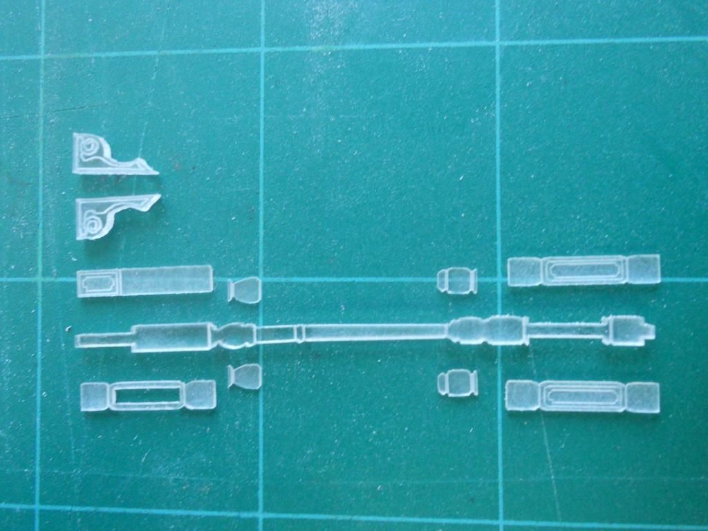

Very nice. where are the rail and post pieces from?

Thanks for all the positive comments guys :)
Everything has been drawn using Auto CAD at home and then laser cut out of various thickness' of acrylic (1.5mm,.8mm.5mm for the posts) at work (in my own time i promise! ;D), only to be brought back home and assemble using dichloromethane.
