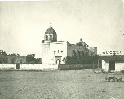

I wanted to make a model that is suitably generic enough to use in other western projects such as western gunfights and Zorro style games, so I have taken some liberties with the design of the church. You can see from the old picture and the movie still that the real church was huge and occupied a vast area.  I have scaled it down somewhat to make it playable and have not been quite so elaborate with some of the design, for example the hexagonal bell tower is now square and the church is not a cruciform shape.

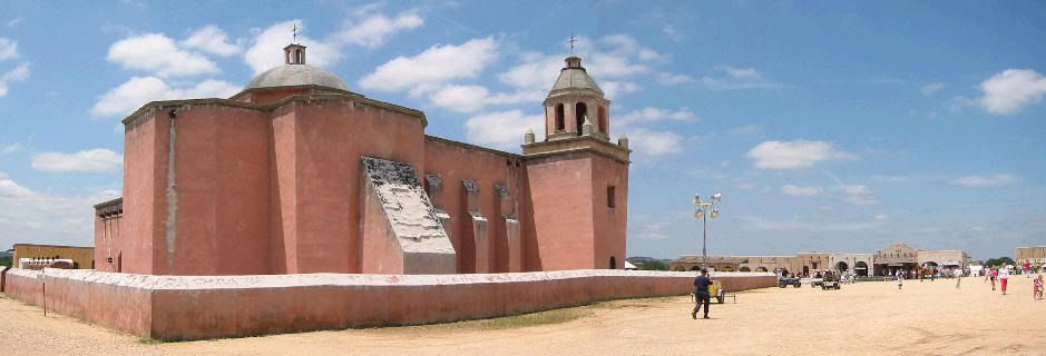

An image of the original church:
Two stills from the recent Alamo film(2004)
