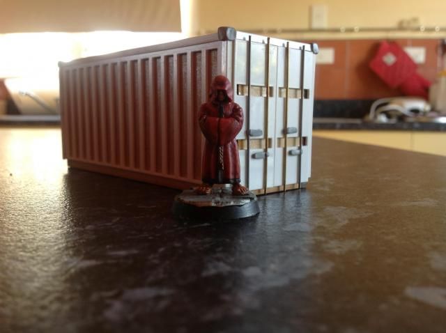

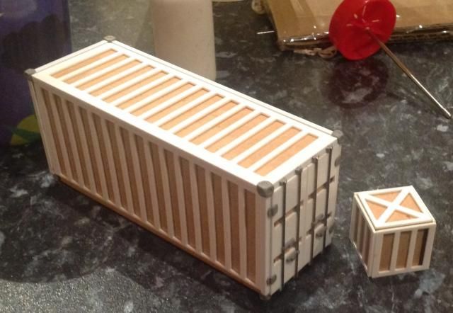

I've been working on some terrain for the rules scurv and I developed for his future sports miniatures.
Here is a piece of impassable terrain that I made. I now just need to make a mould for it which I may do tomorrow if I have time. I also had left over space on the sheets of mdf and acrylic that I got laser cut so I made up a small crate as well. That will probably be used as difficult terrain.
Here's a WIP pick with a eureka miniature for scale as well. This picture isn't of the finished piece though.
The mdf is 3mm thick and the acrylic is 1mm thick. It is going to be hollow on the inside except for some bracing pieces that I also had cut.

Very nice. And you've made me realise what I'm missing opine too. I need the pieces that hold the locking mechanism to the door. That would have been a bad miss.
