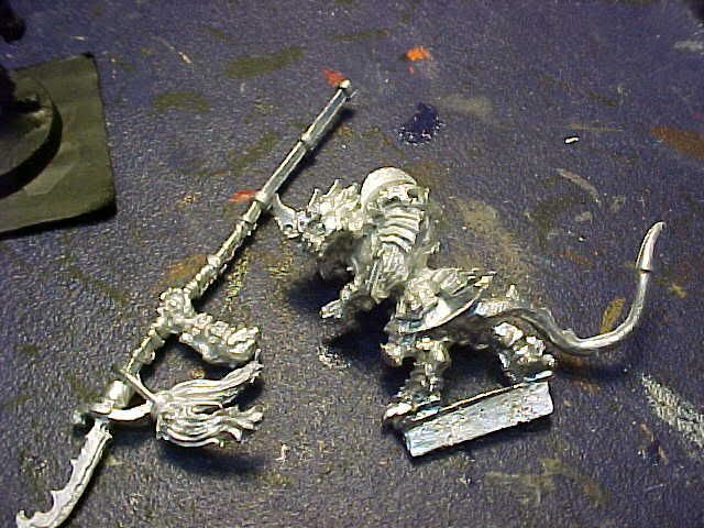

Stage 1
Examine the base miniature. Here are all of the components of the Longstriker:
