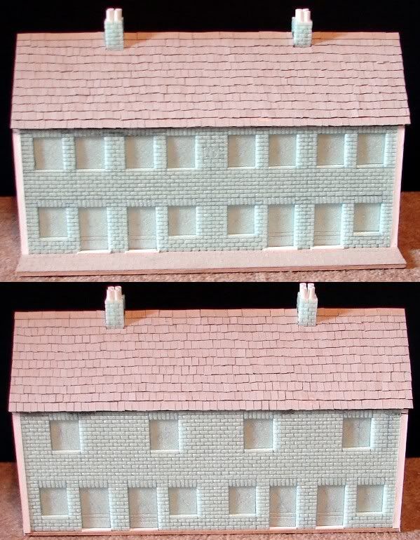

I've eventually returned to my Geezers project.  :)  (Apologies for the threadomancy)
The next building is a bit more mundane, just a row of terraced houses.
I have decided to add the doors & windows at the end, after the main building has been painted, hence they are currently missing.  Painting will wait until I  have made another building or two, so that I can paint several together.
Like the Winchester pub, I will also do a seperate rear for the terrace which will have the back gardens etc.
Next up is another terrace, including a corner shop, then maybe a bank.

'Just a row of terraced houses'??!!!  :o
More inscribed brick brilliance!
Can't wait to see this model finished.  :)

Excellent Paul and these babies could be used for anything too :-*

This is really great looking little house. Useful for a lot of setting too! Fantastic!  :-*

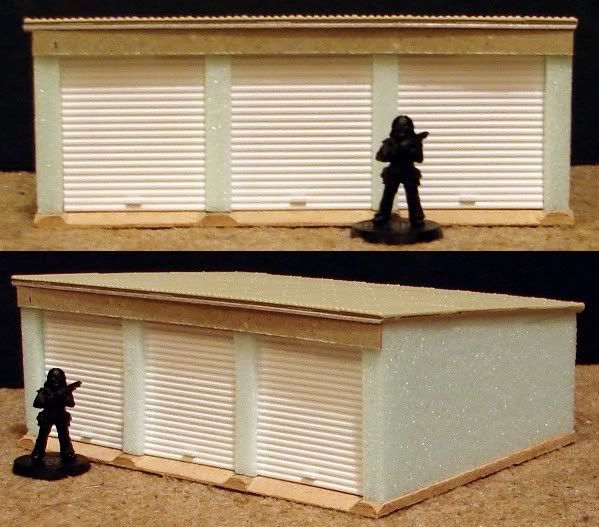

A slight deviation from the plan.  ::)  I decided to do a small block of garages:
When painted up the blue foam should look like concrete.
