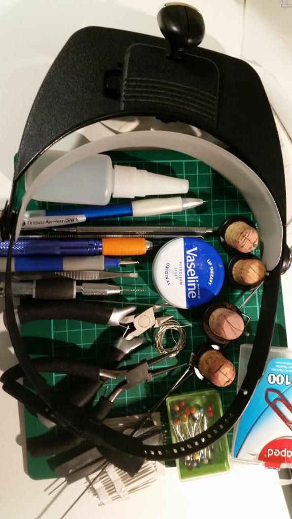

2. You need very little equipment to sculpt. I've got plenty of tools at home but most just tend to get in the way and 99% of times I use my standard sculpting tool and a needle mounted on an old paintbrush or a mechanical pencil. I'm away from home during the week as I have a very long commute to work and have a traveling sculpting toolbox, whose whole content you can see on the photo below.
The two sculpting tools (on the left) are the new GW one, which I like but is clearly overpriced and the old GW one modified probably in a similar way to Vermis', which I've essentially stopped using . A big improvement in my sculpting coincided with my acquisition of magnifying glasses; I can now see what I'm doing, which is quite helpful. The ones in the picture are very cheap ones but include a light. At some point I might improve on these by buying professional binocular magnifiers like the ones used by dentists.
