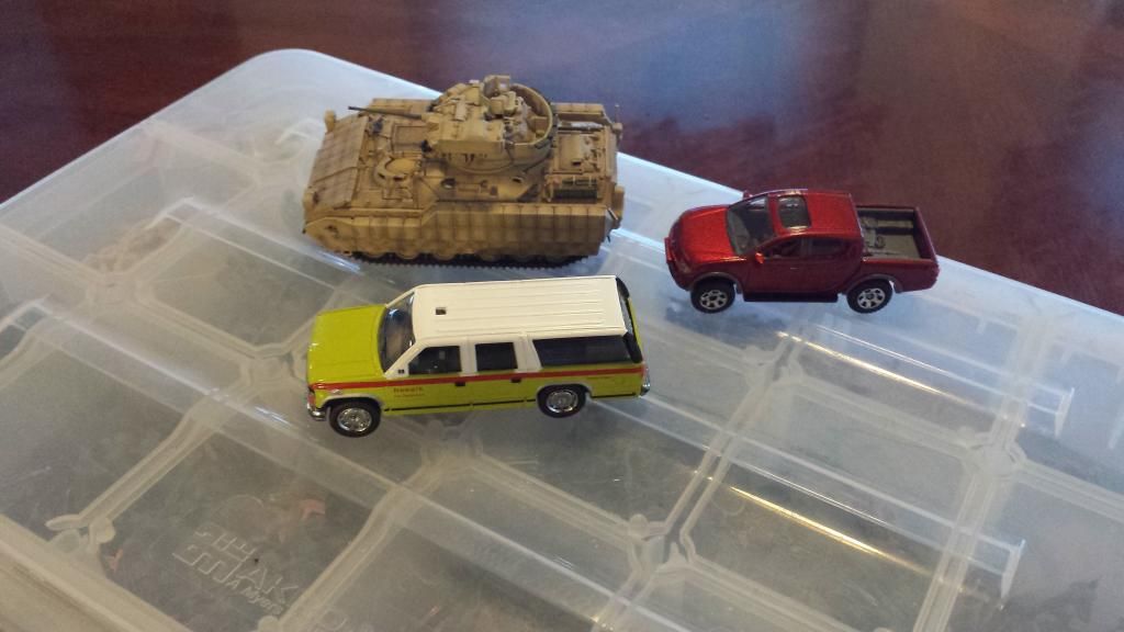

So here is a pic that I took a few weeks ago. I have to reglue the mirrors back on but the base does come off as it is only on by 2 screws. I want to mold a few of the Nissan in the back also as technical vehicles until I can find a better truck.
I was think about putting the clay up to the wheel wells and then pouring the bottom half for a 2 part mold to cast...

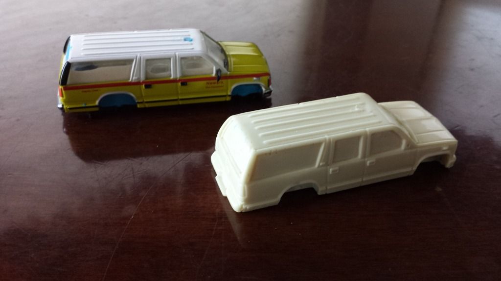

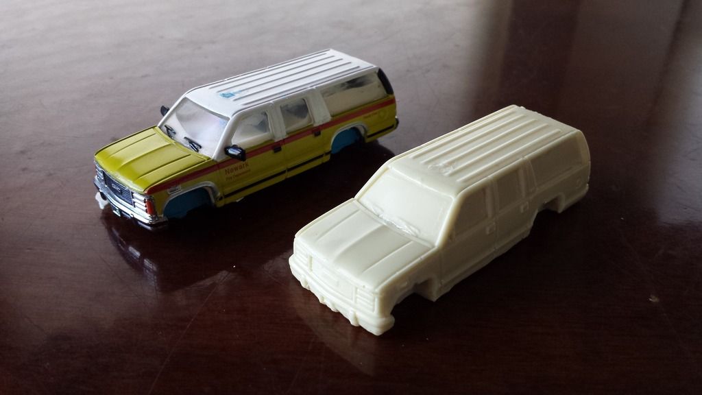

So this is the first run. I molded the mirrors on it and I have the holes but for some reason the resin didn't go into them. I'll push some in with a toothpick on the next one and se how that comes out.
Just gotta sand the bottom and finish the tires.
I thought I sealed all the holes but as you can see my donor now has a mold on the inside.
I think it will be just fine for gaming though. Gotta get rid of a few air bubbles.

Excellent, for mirrors I'd do them seperately. or vent to the body.
