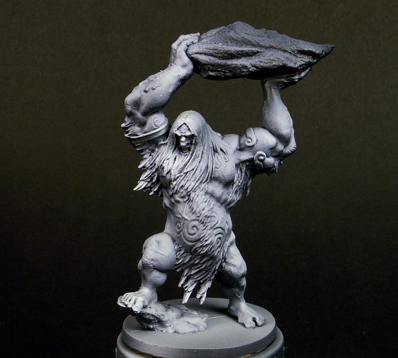

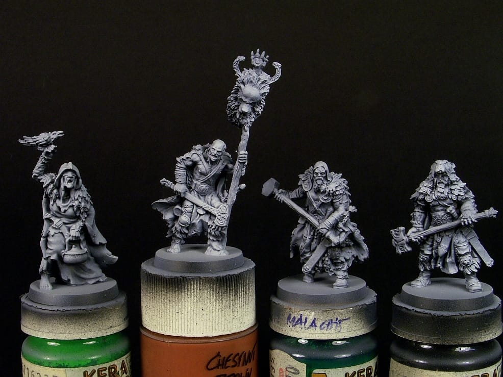

For the normal figures and the frostgiant I used black surface primer with two highlights in light grey and white:

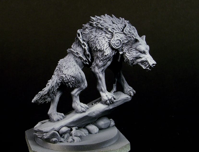

The giant Fenrir wolf (gorgeous miniatures ...) got Panzer Grey with light grey and white highlights as I want to work with some dark and black washes later.
