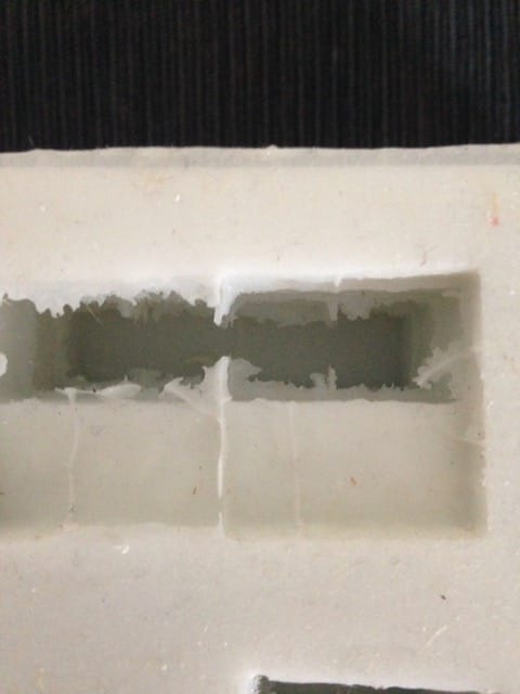

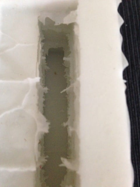

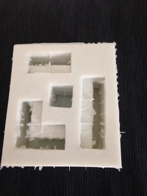

Thank's for the advice all;
Obviously I'd started the project before reading the advice! I've learned a lot in my wee attempt. Please bear in mind that it was Hirst Arts blocks that I was moulding, not miniatures.
Masters: PVA glue is not strong enough when removing masters from the mould! In several instances the master broke during the process. If I was to do this in future I'd probably use superglue or the likes.
Undercut: So I've got a pretty large undercut on the masters, in the form of the floor section. This caused issues in removing them from the mould. In future I'd probably cast the walls and floor sections separately.
Fronging: I've ended up with quite a lot of additional frongs. Should I remove this? What is the best way of doing so? I think in future a bit of time spent with filler on the blocks would help to remove this problem.
Sorry about the poor quality photos
Andy

« Reply #21 on: October 15, 2015, 01:41:07 PM »
That's fine for a first effort. Well done.  :D
You can superglue your master into the box, so long as it's of a material which won't be damaged should you apply acetone to get the superglue off. I use PVA glue on all my masters, but they're rock solid so rarely get damaged when removing them from the mould.
You have to watch out for undercuts, you can smooth them out with some filler or vent them. As you say for this one moulding the components is probably the best way to go.
Snip the frongs off with scissors, any left may come out with subsequent casts. These will have added to any damage the masters suffered. You're best filling all masters, sure it's timely but you save a lot of mould tidying.
Photo's are fine... looking forward to seeing the cast.

Sorry, I missed this before.  Very nice first attempt.  You can cut those tendrils out with a pair of small scissors.  Just leave about a 1/16 of an inch so the crack is still visible on the cast part.
A couple of suggestions.  Firstly even if you do not spend out for a vacuum setup you can still get bubble free casts pretty easily.  All you need to do is paint the silicone onto your masters using cheap disposable brushes.  When you do this really force the silicone into the details and get a good clean coat.  I use these.
After you paint the silicone on all surfaces then you do your pour.  Bubbles that end up embedded in the silicone walls do not matter since they are not touching detail.  Secondly with your pour.  When you pour try to create a long thin stream.  The thinner the better since the bubbles that are formed during your mix  will travel down the stream and pop on the way down.  Also try to pour into one corner and let the silicone move into the rest of the mold.
Concerning the preparation of your masters.  All major gaps should be filled.  Silicone will always find its way into the smallest of cracks.  If you take the time to fill the gaps you will not have that problem at all.  Another helpful suggestion is to seal the masters.  I use the Future method.  Here is a link to find the product in most countries.  http://www.swannysmodels.com/TheCompleteFuture.html  It is a bit of overkill but has worked well for my masters.  For the mold box that is up to you.  I have used both legos and foamcore in the past and they both work.  It is really up to you.  The only difference is how tidy the exterior of the mold looks and since that is not the part of the mold we are worried about it really does not matter.
