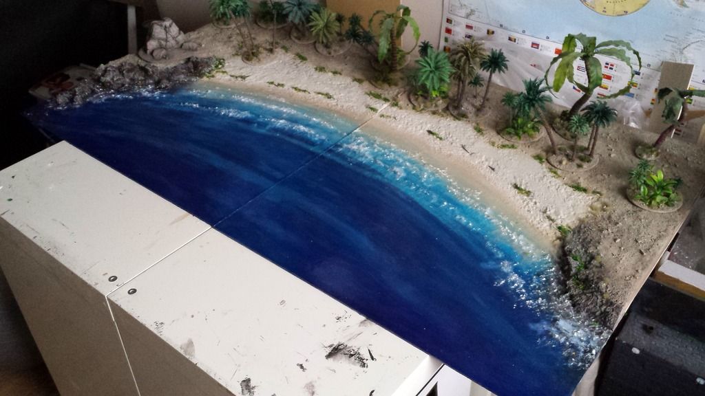

As you say the thickness is just a preference thing. If you don't want huge undulations or rivers or gorges use the thin stuff. In theory if you are doing shallow hills, you could just glue the shaped foam hills directly on to the mdf, leaving some of the flat bits mdf without foam, and cover it in filler.
The blue sea in these is just the plain wood painted. The beach is the only bit done in foam.
As for glue, pva is enough(that's what I use) Just make sure to weight down your glued foam on the board while you're waiting for the glue to dry. I usually leave mine for a day.
