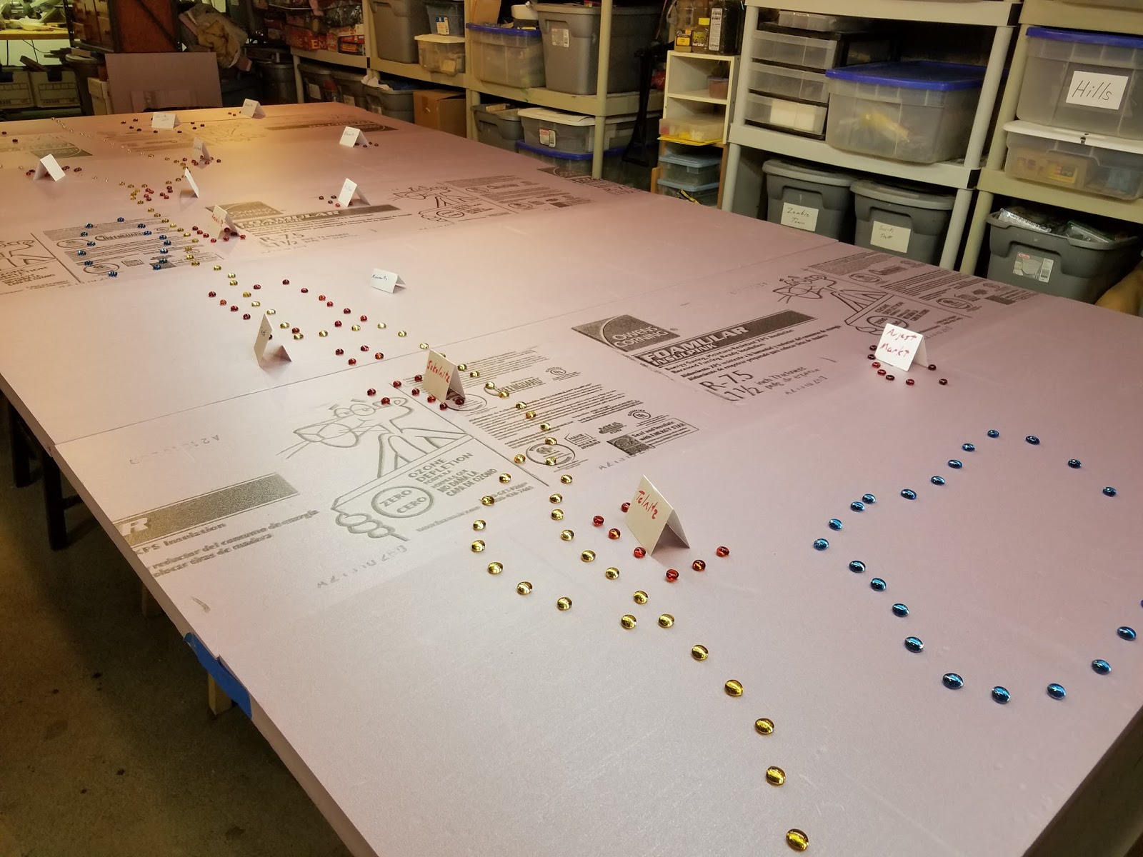

We picked up a lot of Pink foam at Home Depot
6 x 12 feet of Pink Insulation
We use glass beads to layout terrain features. It's easy to adjust them if we make a mistake or forget something. Then we draw them out with a Sharpie Pen

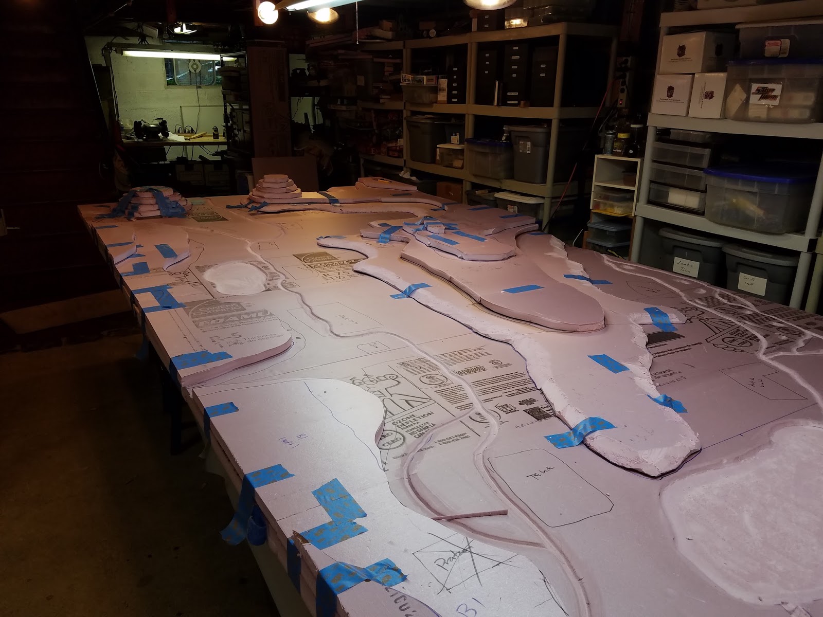

Carving in water features with a Dremel
Adding Elevations for the hills
Now we have to finish carving a slope in the foam.
