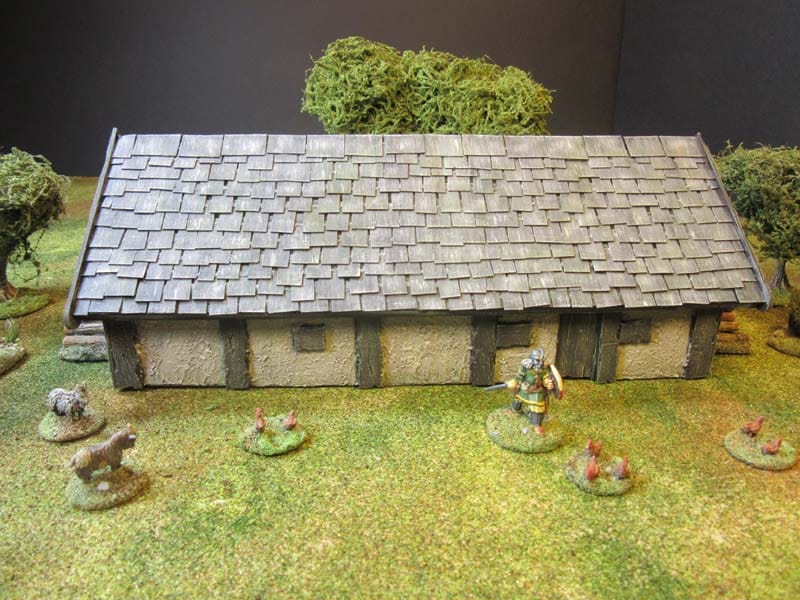

As the title says I aim to build a small Viking/Dark Ages Northern Europe village and would appreciate feed back on what I am doing and how I can do it better or differently.
For reasons that I can not fathom now, my 1st build was the chieftains long house, should have been the last after I had some inkling of what I was doing.
So this is already done and I'm not sure I will go back to it :?
However I don't think the roof shingles work very well, the shingles are too big and I was a bit lazy and spread them out a bit too much. The thing I would appreciate advice on is the texture of the shingles. I used a fairly smooth cardboard and tried to compensate with downward brush strokes to get texture, but it does not look like wood to me, any thoughts?
For painting the roof I went with a black undercoat and then dry brushing gradually lighter shades of grey with a final green brush to simulate moss growth. Should I do it a different way?
I like the wall texture but it should be "puddled mud" ie daub pressed into the wattle by hand and so should be a dimpled finish, this is too sharp. Again any thoughts?
Next up will be a couple of small houses that I have just started working on. These will be similar builds, ie foam board structure but with thatch roofs and I am going to try watercolour paper to get the hand dimpled finish.

Looks good  :)
Maybe a fancy bit of carving at the apex of the gable might help to set it off? A stylised dragons head or some such.
Re: Vagabonds Viking Village
« Reply #3 on: 29 November 2016, 11:26:04 PM »
Looking good, sir.

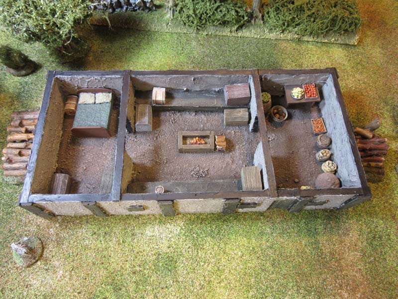

The interior has reached the right blend of nicely detailed whilst still 'playable'.
 8) 8)
If you are not happy with the roof you could always cheat and give it the teddy bear treatment (thatch).
Second the idea for the carved gable, or even a great aurochs-type skull or similar.

I am sure you are both right it needs a figurehead. How do I carve one?
I wanted to do shingles on the roof because it is the chieftains dwelling, and he would have expensive roofing, however but would like to improve the look of them.

I think I would have gone with at thatched roof. The shingled roof makes it look a bit more medieval than dark age.
Carved out gable ends would really make it into a viking house. But then again perhaps a Saxon who suddenly died of acute Axetothefaceitis lived there just a short while ago ;)

Dr Zombie - I am coming round to that way of thinking, last year I went to Denmark and visited Ribe, Trellebourg, some place I can't remember and Hedaby in N Germany, I have just gone back through my Photos and there are only 2 houses with wooden shingle roofs and both of these had the walls constructed of timber, rather than daube and wattle. All the others were thatched. Bugger.

Go with the toweling on the big house.

Very playable and looks great.

Marine - ok I am convinced, I will thatch the big house.  lol lol
