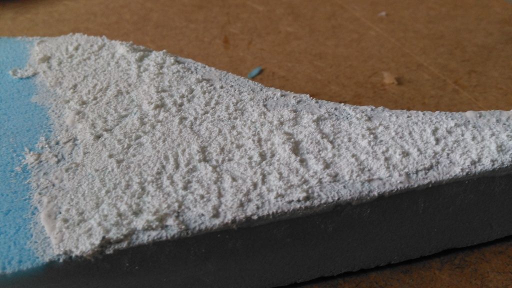

« Reply #7 on: 09 December 2016, 11:37:12 PM »
Try this.  Easy to apply with a small pallette knife and then stipple for effect.  Drys hard.
This is it used on a terrain board but it will work on bases as well.
Available at craft and art shops.

« Reply #8 on: 10 December 2016, 11:21:43 PM »
Looks quite good, I'll see if it is available around here (Denmark is like the Back of Beyond when it comes to DIY and deco materials, as compared to the Anglo-Saxon world).

« Reply #10 on: 11 December 2016, 06:46:43 PM »
I could send you a tub if you would like.
I might take you up on that - provided it is possible to send it from the UK (I think there are limitations on 'liquids', which I don't know if this classifies as)?
How much does that tub contain (sorry, I do not trust my eyes to decode the text in that picture - does it say 110 ml)? And what is the price?
I have found a Danish webstore selling it in 59 ml tubs for DKK 39 (+ postage), about £ 5.5 excluding postage - but that might be about half the quantity available to you?

Argonor,
It is a pot with 118ml of paste. The local cost is £4.99.  There is enough in one pot to cover a bit more than one 1' x 1' terrain board or possibly about 100 - 150 miniature bases depending on how thick you layer it.
I am sure that the paste will not be a problem to post.  Drop me a pm if you want a pot. The cost to you would be postage only.
