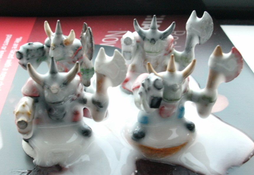

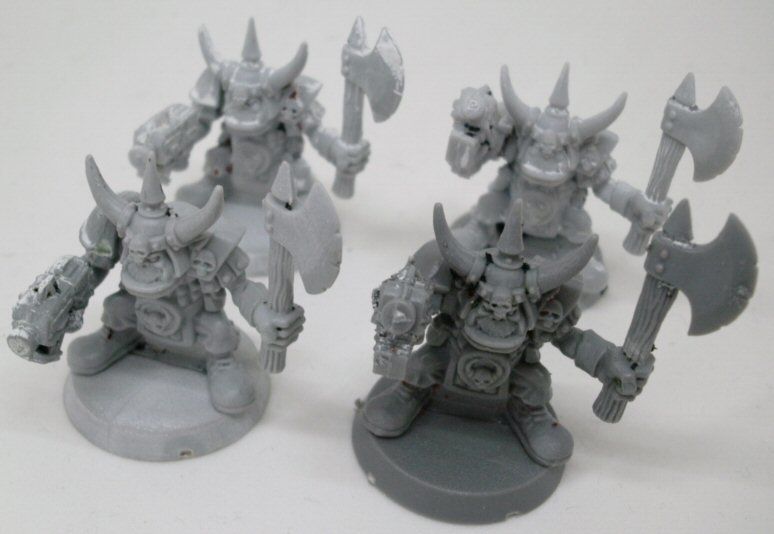

I highly recommend Biostrip if you can get hold of it in the US (guessing that where you are because of the currency  :)) It's fine for plastics and doesn't smell like the cleaning fluids.
Started with
then after a hour with this goop on...
I ended up with pretty clean minis. The white primer seems to cling but i reckon another soak in goop would go a ways to shifting it.
