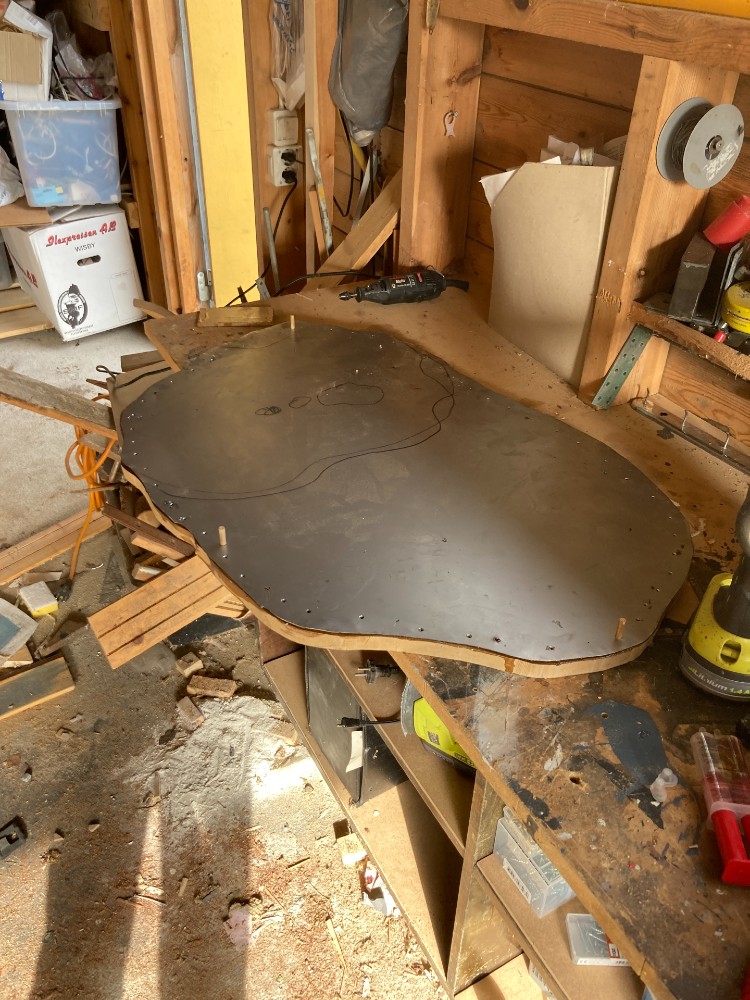

I purchased a scrap piece of 25mm MDF from a local lumberyard and, using the sheet steel and the acrylic sheet prepped previously as templates, I cut out the shore line:

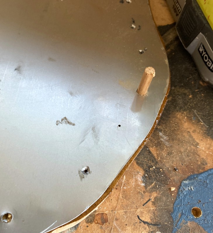

To make sure a good fit I drilled three guiding holes through the steel and MDF and put 6mm dovels in them. This way, once the epoxy glue is spread on the join, I would be sure the pieces come together exactly where I want and with a minimum of sticky goo ending  up where it shouldn't.
...like so...

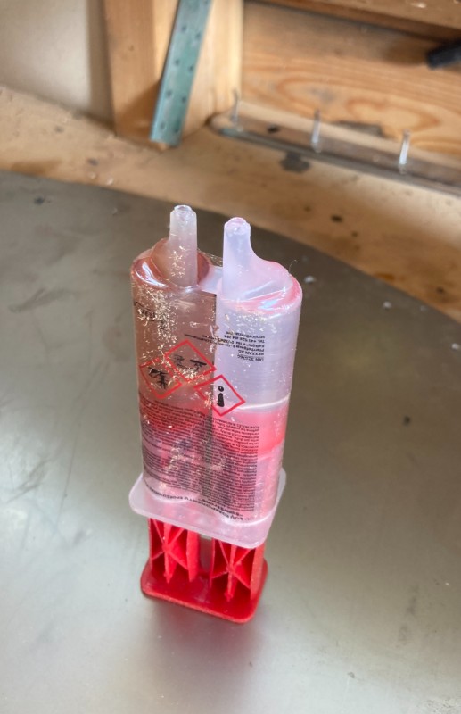

I used a combination of ways to fasten the steel sheet to the MDF as a need a very snug and durable join. First an two part epoxy....
to ensure the poured resin wont seep. Two part epoxy can be pricey but I sourced this kind incredibly cheap (c:a Euro 1,5) from a Lidl bargin bin. It is a bit slow to cure and sets a bit  harder than your slightly more flexible Loctite kind.

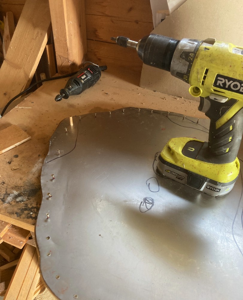

Before I applied any glue I drilled a multitude of 1mm screw holes around the shorelines, which I also counter sunk to make sure the scenery piece will sit snuggly on the game board.
I used 10 mm screws to make sure I could shape the MDF with a belt sander later on, without the sanding paper being torn up by the screws.

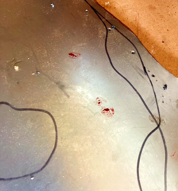

And no piece is complete without a mandatory blood sacrifice. I baptized mine this morning when I reached for a fresh X-Acto blade from a half opened drawer.
Good news; I got the blade. Bad news, its point was embedded at least 2mm into my right hand thumb... ::)
