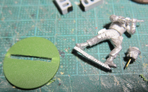

Second, cut a slot in the base and trim the tab.
Another Crooked Dice figure, this time an X-Commando (with a police woman head).
