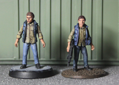

There are three ways.
First, cut the tab off, file the feet flat and use a pin.
Two William Killian.
Second, cut a slot in the base and trim the tab.
Another Crooked Dice figure, this time an X-Commando (with a police woman head).
