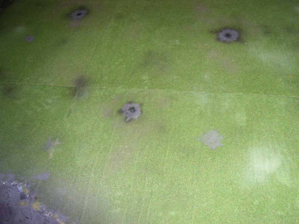

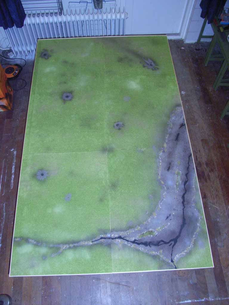

What I did was use a variety of spraypaints to create more interest. Mostly browns, yellows, blacks and greys. I misted those over the surface, taking care to not aim directly at the surface when spraying close to the surface.
I mounted my mat on a wooden board, and to facilitate the painting, I stood the boards up against the wall, which helped both in making it easier to reach the whole surface and also because I could easily step back to judge the results from a distance.
Also, I did this whole thing outside, which helps avoiding domestic disputes... ;)
As some extra detail, I added some craters too. Well; the impression (sic) of craters anyway :D I took a dark brown and black spray can and here I did spray close and concentrated on one area. First with the black, then with the brown. I then applied some white glue in a rough circle around the spot and sprinkled sand on top. When dry, I misted the whole 'crater' with a sand/pale yellow colour again, to blend the whole thing together, and I was pretty happy with the result. From an agnle it actually looks like a small impact crater, but it's still completely flat, so your units can move over it without being impeded.

Real quick, so I can finally get to bed, here are some pictures like I promised. I'll elaborate later, if there are any questions :)

Wow, that looks great.  Is it all flat enough to put terrain on?  If so, you've achieved an excellent illusion of depth.

Actually, the entire surface is completely flat, bar some small glued down pebbles around the dried riverbed (that's what I call it, and I'm sticking with it :D ). Buildings and other types of terrain can be placed right over the features and none of them impede movement.
