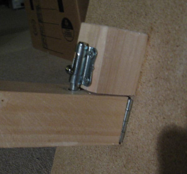

So, here the underside of the now finished table:
And some close-ups:
Here, the bolted leg:
The blocks for the draw-bolts were just glued on with white wood-glue at this point. I consider securing them with a screw or two from the top side of the table.
I'm also going to add some magnet-strips to hold the legs in folded position during transport.
If I had to start this project from scratch, I'd go buy some hinges specially made for folding legs, though. There's a link further up this thread, I think...

The draw bolts are perfect. I really like the design of yours. If I build a Mark II version of mine, I'll be doing the hinges and draw bolts since attaching the legs before each game is a drag.  :)

Well, through trial and error, man shall learn....
But as I wrote, there's some hinges available especially for folding legs, and I think they actually have a device to lock in plade when unfolded. Those would spare the happy constructor a lot of head-aches  ;)
