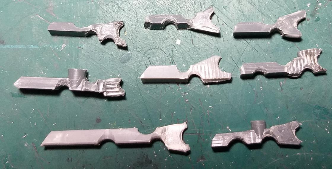

Hello again all,
Here;s a short tutorial on how to build hand weapons using just sprue.
Simple build.
My tools are fine point clipper, a tile snipping pliers for plain flattening & a flat tip long nose pliers for texture flattening.
Chopping tools are made from ground and sharpened broken off blades ( have to be short for robustness & very sharp for clean cuts ). Needless to say sharp means dangerous , so do be careful with blades.
( having said that , even blunt crochet needless are said to be deadly in the hands of very upset grannies  :D :D ;))
Thin flat, triangular, square & round files ( I put a piece of plastic on my round file as it has a nasty point which can poke an eye if one is not careful)

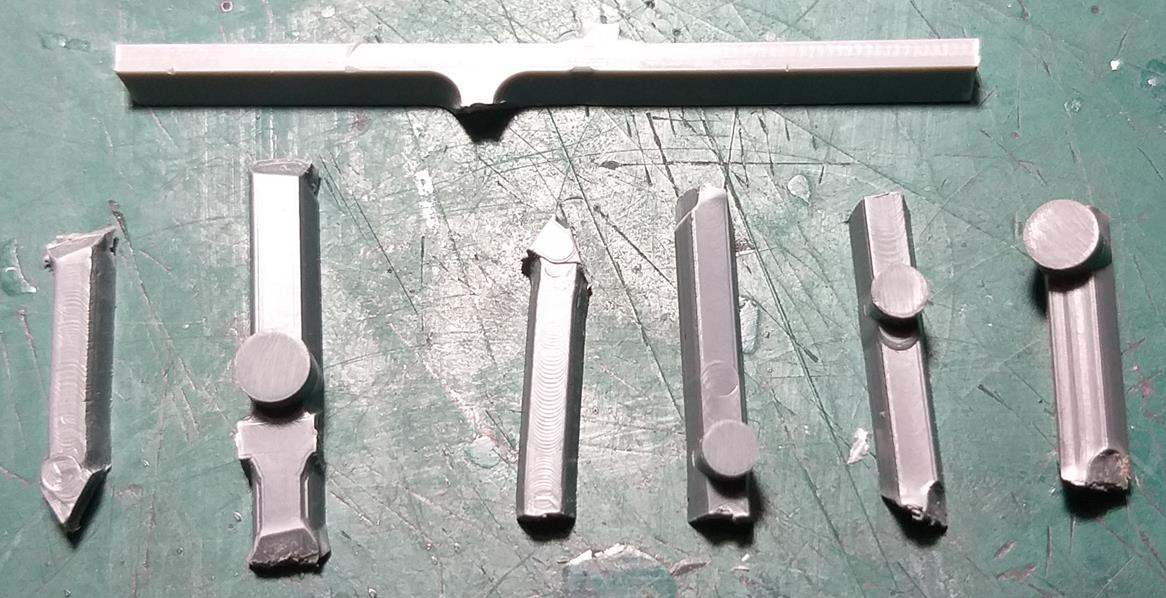

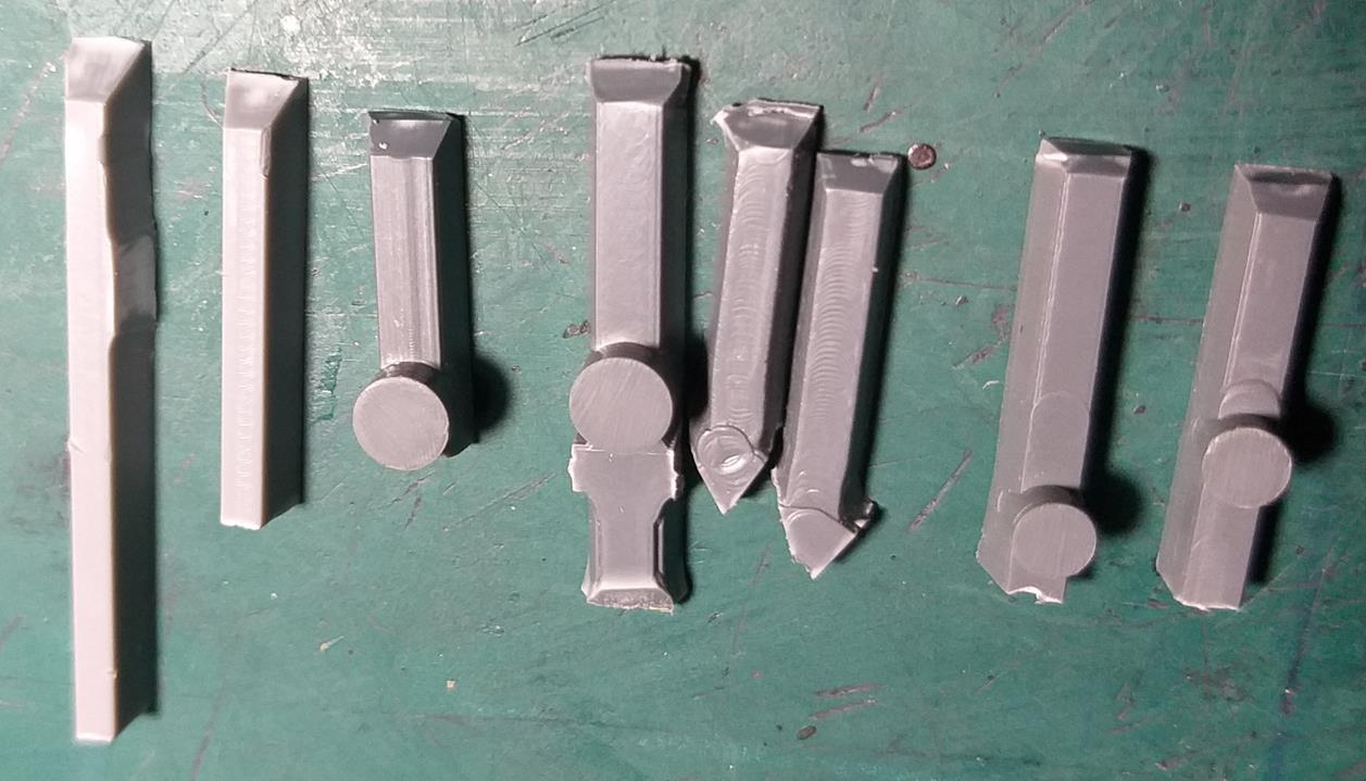

1) All sprue is equal but some are more equal than others. This means choose the sprue bits you like.
2) Chop off sprue slightly longer than needed. Clean off sprue with flat file to have a decent flat surface. Cut sprue end at a chamfer ( blade bevel has to touch sprue so that blade slides at an angle as it cuts. Putting the flat side will result in a straighter cut ).
Drill exit hole now as later might be difficult to do.

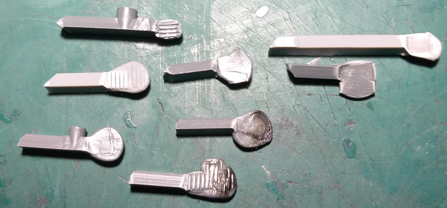

3) Flatten end either cold or hot ( hot means it is very painful if molten plastic sticks to your finger !! ) after heating on tea candle ( the 2 on the right are cold flattened the rest hot ) Notice cold flattening crushes the plastic whilst hot takes the pliers indentations better. Mind your fingers when pressing as it is very easy to crimp them in the pliers.

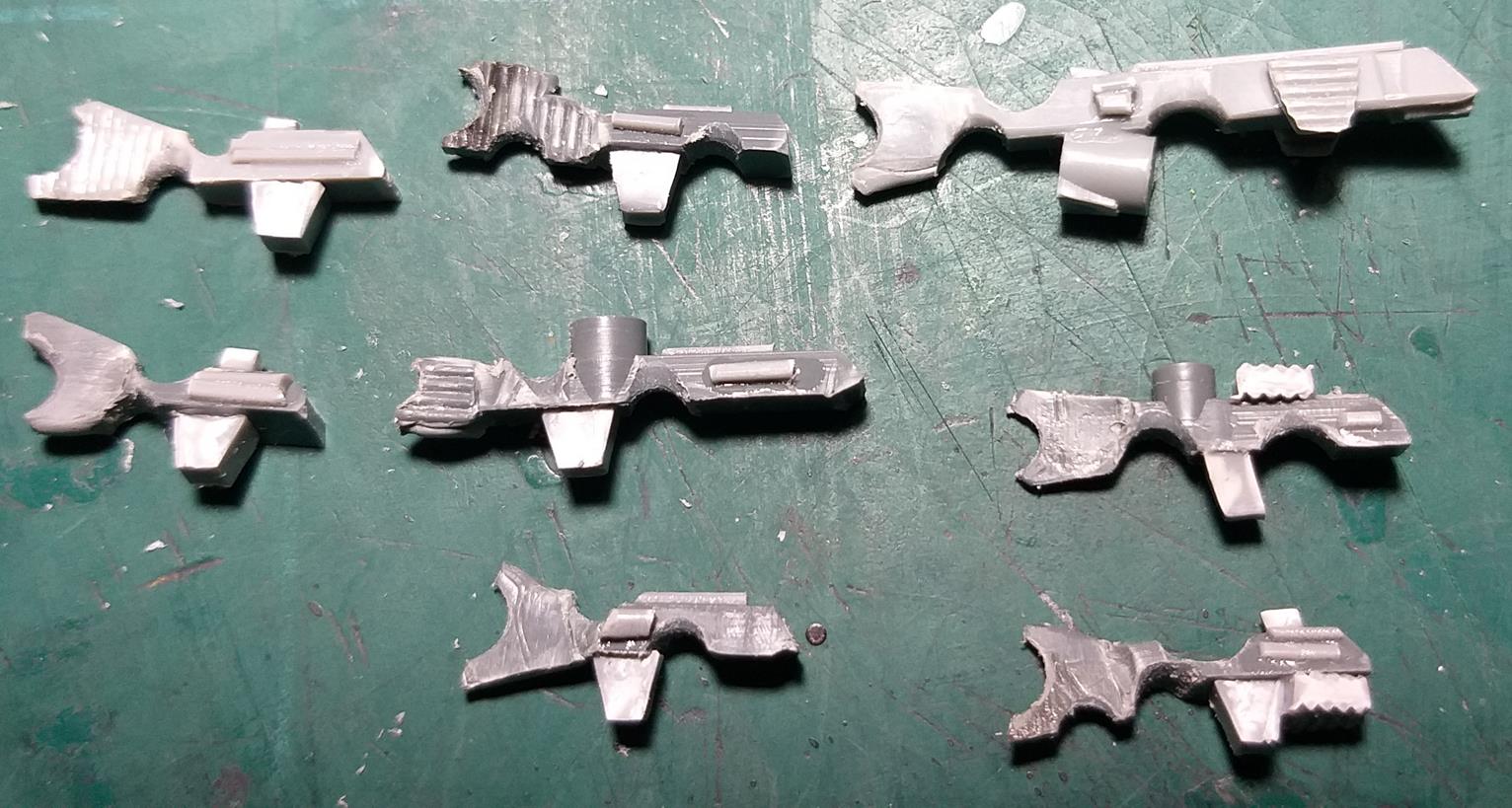

4) Using files , file away shapes to create butts , hand grips etc until you are satisfied with general shape.

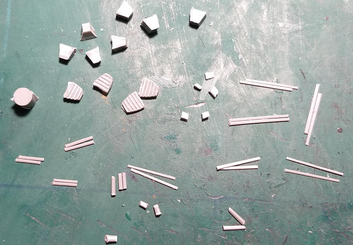

5) Prepare small pieces of sprue, pulled heated sprue etc ( for garnishing :):):) )
6) Start to glue the pieces to your hearts content.This lot took around 45 mins or less to make.
They're scaled for 15/18mm like the ones I used for my McGraw gang
Thanks for your comments.
Z

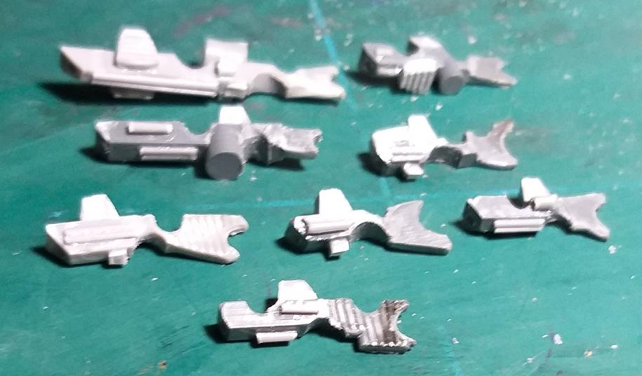

You really should. Very easy to do ,much simpler than pushing putty as the sharp straight edges are ready. Yes?
My advice is to prepare and build the mini's hand/appendage/proboscis on it.
Stick a piece of wire in it so that it can then be easily inserted into the mini.
By far the best pins I found are hair pins , cheap, easily cut and bent into shape.
These 2 new ones are different & need more filing to create the grip.
Enjoy
