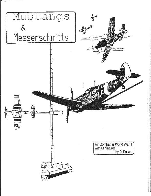

Edit:  Forgot the old Mustangs and Messerschmitts flying base.
https://dtrpg-public-files.s3.us-east-2.amazonaws.com/images/2747/219901.jpg

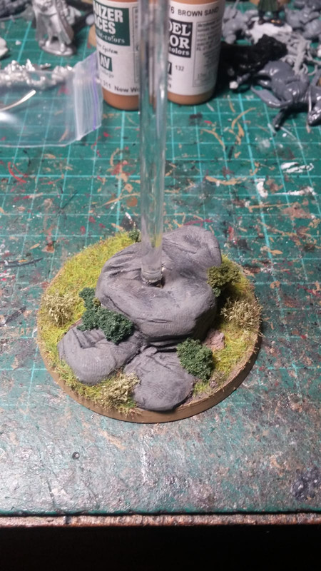

I modified their flying stand to use with a scenic base on my Eldar some time ago:
https://4.bp.blogspot.com/-68HdZKhZ2iY/V16yTpNNcuI/AAAAAAAABMA/zy48ds1rJDo7jsSovOKjHcMeGfAJTwMEwCLcB/s1600/DSCF1238.jpg
