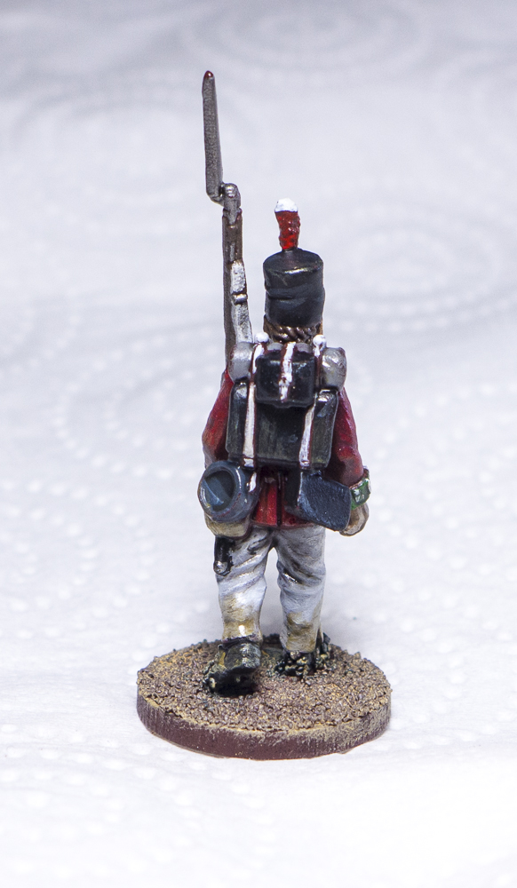

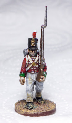

Here's the test model to work out colours and overall scheme.
The colours in the photo are a bit off as it is a quick snap, but it gives you a good idea of where it is going. So I can remember what happened for the next one, this is the process. They are based on 20mm round bases so that they can fit into 2x2/40mmx40mm square bases for larger games as well as being useful for skirmish level games. Speaking of... the base isn't done yet!
The process so far is similar to the Warlord step by step with a few additions/modifications to fit my painting style and paint selection.
I'm sticking with the green as this is the colour of the 66th (Berkshire) Regiment of foot, which is where I'm from. They also served in a lot of the major battles of the peninsular campaign such as Douro (1809), Talavera (1809), Albuera (1811), Vitoria (1813), Nive (1813) and Orthes (1814). I've no idea how well they did, so that is some other fun research for later ;)
My steps are as follows (mostly for my reference so I can repeat it later...
1) Undercoat - Army Painter Chaotic Red spray. This is basically VMC Hull Red and acts as a good shade for skin and the red coat.
2) Trousers - Base coat of VMA Sea Grey, layer of VMC Sky Grey, thinned highlights of VMC Offwhite. Glaze of Warpaints Boney Spikes/Gloss Medium to add dirt around the bottom
3) Jacket/Hat trim - Thinned layers of VMC Carmine Red; trims Citadel Warpstone Glow; final wash with Devlan Mud. Random glaze of Warpaints Boney Spikes/Gloss Medium to add dirt
4) Straps/Hat trim top - VMC Off White; wash of Devlan mud
5) Boots/ bags/ shako - Black with VMA Grey Green highlights.
6) Musket - VMC Leather Brown wood; Boltgun Metal for metalwork; overall wash ofNuln Oil
7) Skin - VMC Cork Brown; thinned layer of  VMC Basic Skintone; wash with Devlan Mud. Stubble: 50/50 Black/VMC Basic Skintone painted onto jaw
8 ) Canteen - VMC French Mirage; Wash with devlan mud then Nuln Oil
9) Hair - VMC Leather Brown; wash with Nuln Oil
10) Bed roll - VMC Neutral Grey; wash with Nuln Oil
11) Sack - VMC Stone Grey; wash with Devlan Mud; stains with Warpaints Boney Spikes glaze.
12) Hat badge - VMC Bronze; wash with Devlan Mud
Doing one took about 2 hours, so we shall see how long it takes to do 4 more...
If you spot any serious historical mistakes anywhere in this thread, just shout. This is all pretty new to me and I'm bound to miss something in my vague attempt at research
 :o It's not a rifle yew slovenly sowjer yew... it's a musket!  :o

Don't think it's a serious mistake, but I would do the canteen a lighter shade of blue, otherwise not to bad.

He looks pretty good to me. I like the sound of your project, looking forward to seeing more.

That figure looks good to me.
