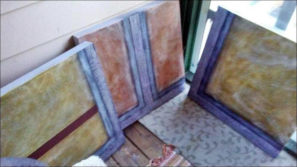

I started with a number of 12" x 24" x 2" blue foam boards I had picked up for free some years ago, and were languishing in my shed, and glued together 6 of them into 24" x 24" boards.  I only had seven, so for a fourth board, I glued together 2 layers of 1" blue foam I had gotten at the same time to make a 4th 24" x 24" section.  I then scrounged up a 24" x 48" piece of pink insulation foam that was heavily damaged on one side, and added that to the mix so I can build my standard 4' x 6' gaming space.
(I am a longtime Warhammer player, so I can't help but think in terms of 4' x 6' when it comes to gaming.  Sorry, even though I have not actually played 40k since 4th edition, I started playing it with Rogue Trader, so certain patterns are locked into my gaming mind.)

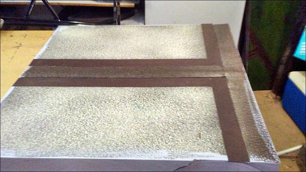

So I started looking around for stuff to use for roads, and I found I had some of the ridiculous cobblestone rubber stuff that you can find on sale dirt cheap just after Christmas from Lemax, and started cutting it to size.  I then decided to add sidewalks - as I was looking for references, I noticed that the majority of photos I could find showed that there were at least small sidewalks in most areas of urban Europe, and they certainly existed in the US, so I used some sandpaper I had around.  It was a belt from a large industrial machine, so I could cut some good lengths out of it.  I then mounted these on with a doublesided tape I picked up from work that we use on banners.
And started painting...

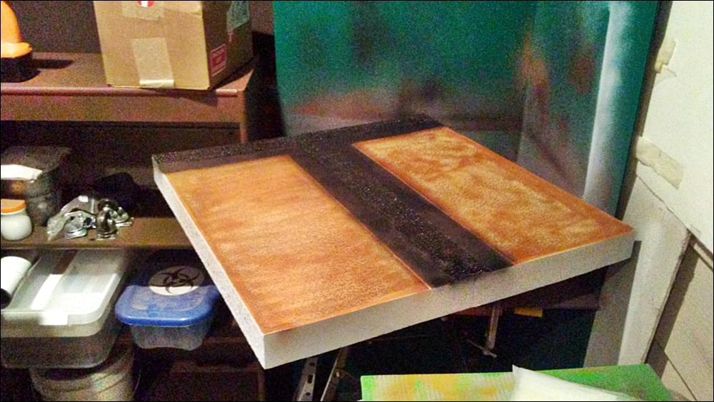

I textured the terrain with a spray-on fleckstone, and used my airbrush to put a black primer coat on the roads/sidewalks.
Then, the drybrushing began.  I used a color scheme to match my post-apoc - I decided if I need to make it look more green for say, Market Garden, I could do that by adding grass patches and park/garden pieces.  Then it can serve both duties effectively.

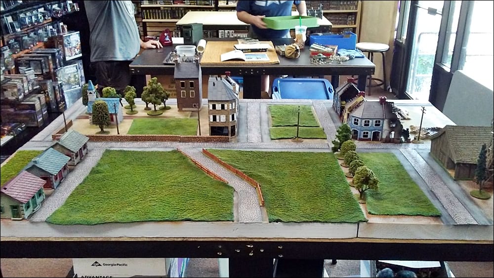

I then found an old green blanket I had been using for a cat bed and airbrished a lighter green on the top points to cut into grass patches.
And this was the table it debuted on, when I was playing Bolt Action with a friend.
Considering I managed to find everything I needed for this project in house, so there was no monetary outlay for anything in the project, I was pretty damned pleased.

Looking good!

Very nice Neil.
Lemax copplestone roads are great.
They look great on your table.
