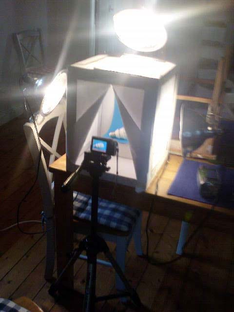

Since I managed to unearth my dented old reflectors I thought I'd make another post. I have arranged them around the tent like so:
I got these three clip on aluminium reflectors in the US several years ago. All practical miniature photography sources seem to pretty much agree on one thing: they are all you need and are the most versatile. For bulbs I put in 11 Watt low energy bulbs, equalling 60 Watt environment hostile ones. (This one is actually shot in the photo tent.)
I picked this simply because they are what I currently had at home. These bulbs, apart from being environmentally friendly, have the bonus of not generating so much heat, thus lessening the risk of warping and browning the paper in the tent. The drawback is th price and that it takes the little electrical daemons in there several minutes to stoke the fires in them to their maximum radiance.

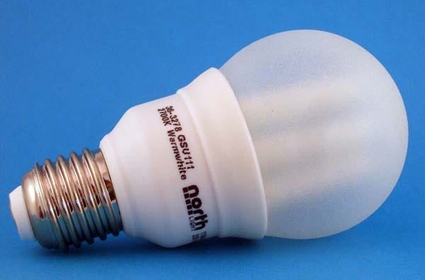

As they had, alas, it became fairly obvious that they were not giving of sufficient light. It actually says 2700 K warm white light on the other side:
This means that they light provided is slightly yellow. We don't want that. The white paper filter compensates this to some degree but also absorbs some light. Looking through some literature (among them Orctraders tutorial in 'How to...' and 'How to Photograph SCALE MODELS' by Shepard Paine and Lane Stewart) I come to the conclusion that at least one bulb needs to be upgraded to at least 15 Watt l.e.b. (equalling an old 100W bulb). No problem, I'll take care of that tomorrow.

When you arrange your lights towards the subject you should think of them as main, fill and backlight.
The first, the main light, is exactly that and should light the side which has the most interesting detail. The front if you will. Or the direction to which a miniature is looking. Or an imagined light source in a setting. This lamps should be placed slightly above and to the side of the subject and it should be of medium wattage.
The second, the fill, is used to light the details on the other side of the subject and to reduce but NOT take away the shadow the main light creates. This one should be placed at the same hight as the camera lens and, obviously, on the opposite side of the subject  It should be of low wattage. The impact of this lamp can be adjusted by simply moving it closer to or away from the subject.
The third light, the backfill, is the lightest and serves to separate the subject from the background by illuminating the background more brightly or by illuminating the subject from behind or both. It should always be placed above and behind the subject.
Alright then, now, ahaha, enlightened by this I think I will sally forth and buy not only one 15W bulb tomorrow but two and also a 7W or similar. Then we shall fiddle anew.
A final image of the whole set up including tripod and camera, taken with my mobile.
