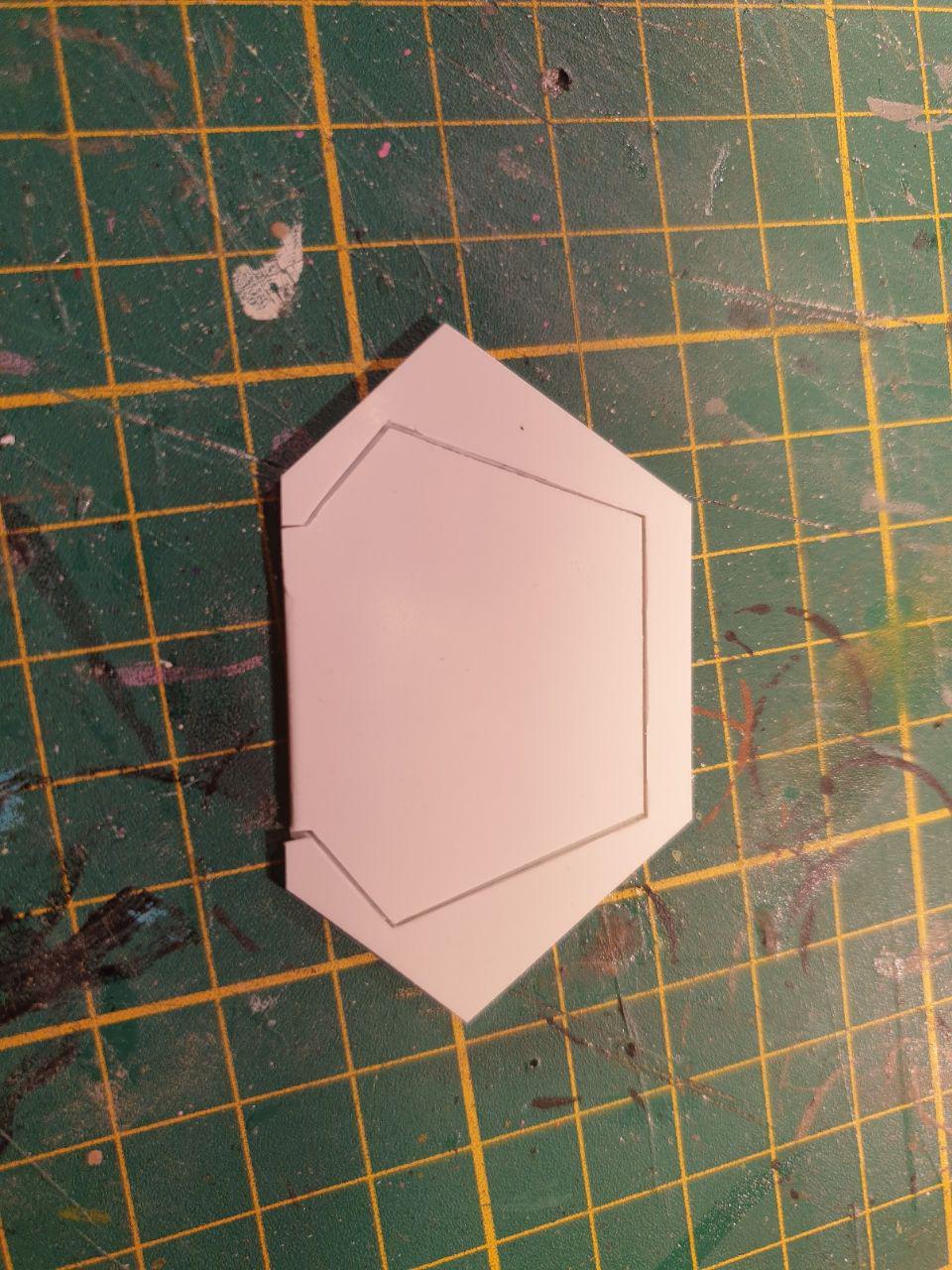

So I finally set about with different thicknesses of plasticard, a printed out copy of the templates and not enough time on my hands (as usual):

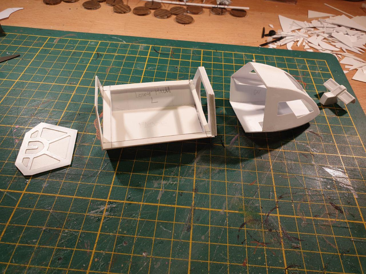

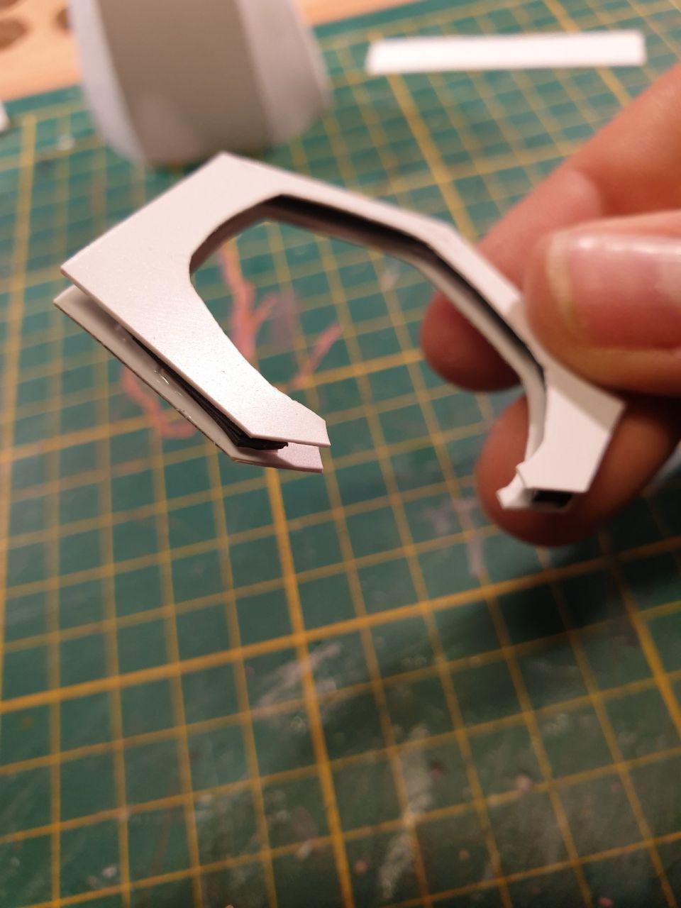

The most complex curves on the model were to be found on the cockpit area, so I tackled this first. I basically used the templates as is (sans the tabs), and I cut out the center area of the central horizontal piece (in the picture above). It is defining the curvature of the nose, and is also a major structural part of the construction. I ended up using it as the basis for the cockpit interior.
Here's the top half of the cockpit:
And here is the cockpit, very roughly glued together. It will require some copious amount of puttying and smoothing out later on, but I was pretty pleased with how it was coming along.

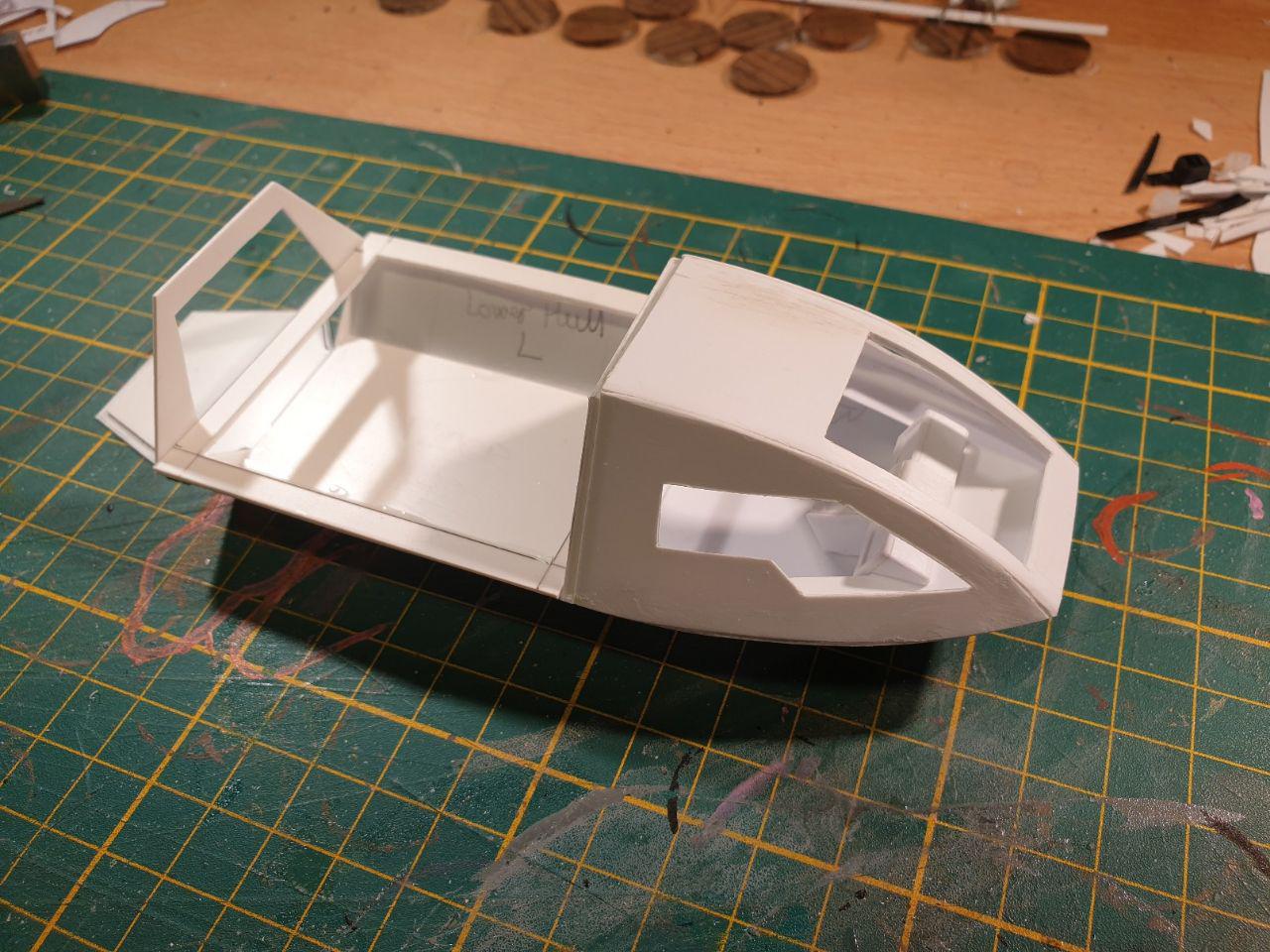

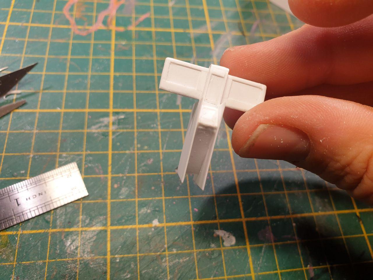

I then started roughing out the cockpit area. I decided early on I wanted it representative, but not an exact copy of the studio model, mostly because of time constraints and also because it's really just a gaming miniature, and something as small and obscured as a cockpit might actually be fudged a bit without even the trekkers throwing a hissy fit lol

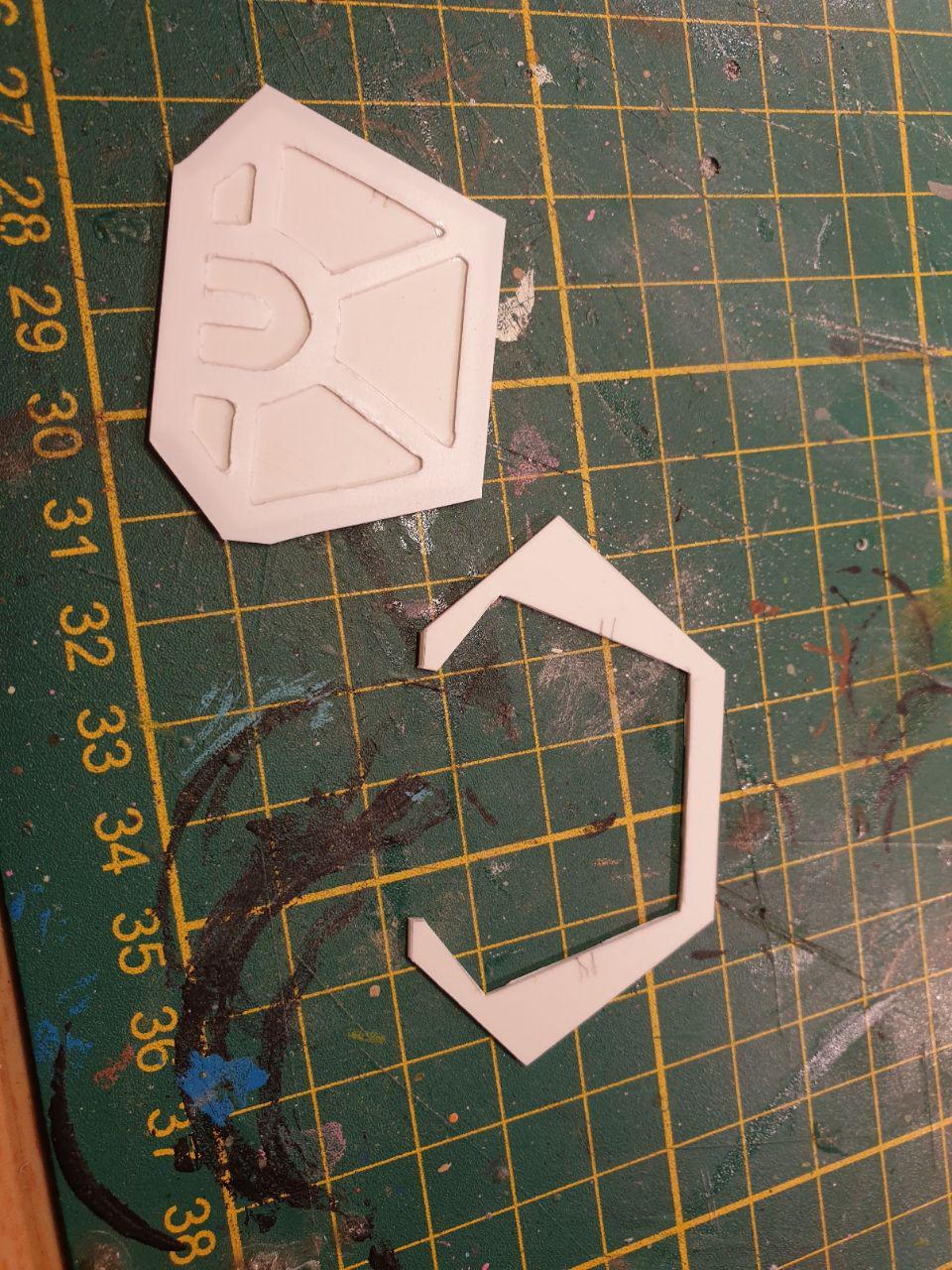

I then needed to create a bulkhead (I'm calling it that anyway) behind the cockpit, based on one of the few online pictures I could find of the interior of this shuttle:
(for the observant amongst you; have a laugh at the expense of the completely unattached warp nacelle; poor Scotty never knew what hit him when he took off lol )

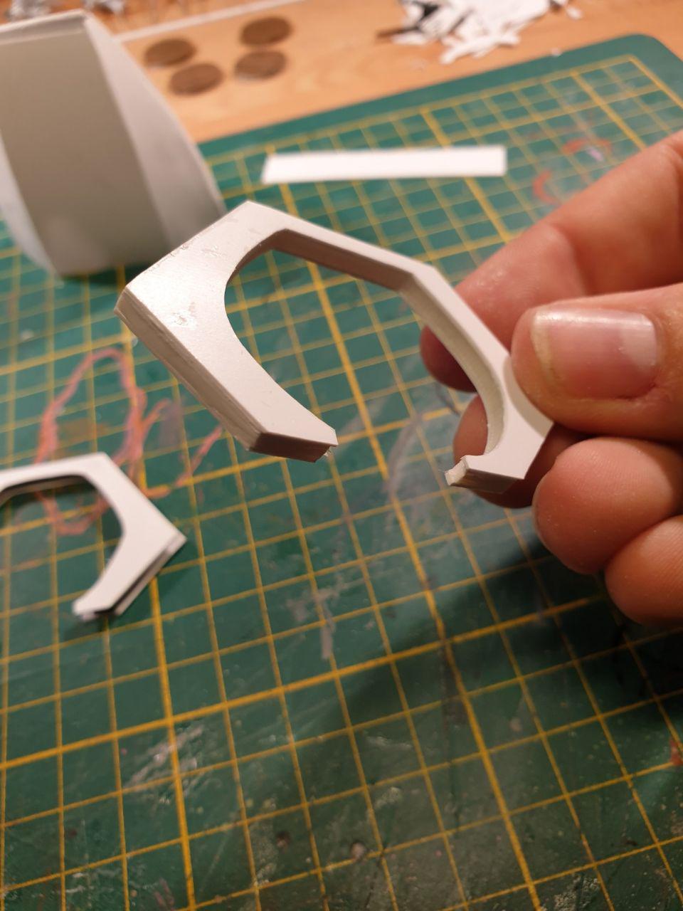

It's the ribbed thing behind Scotty. I had seen people using TieWraps for exactly such a purpose and I decided to do the same. But my first attempt was rather bad. I used off cuts as spacers between two identical bulkhead shapes, but the TieWraps proved too stiff to keep their shape when glued without support, so I made a second attempt, with thick plasticard spacers that fit exactly, with the thickness of the TieWraps spared out, sandwiched between two regularly shaped bulkheads. And this yielded the desired result:
Bad
Good

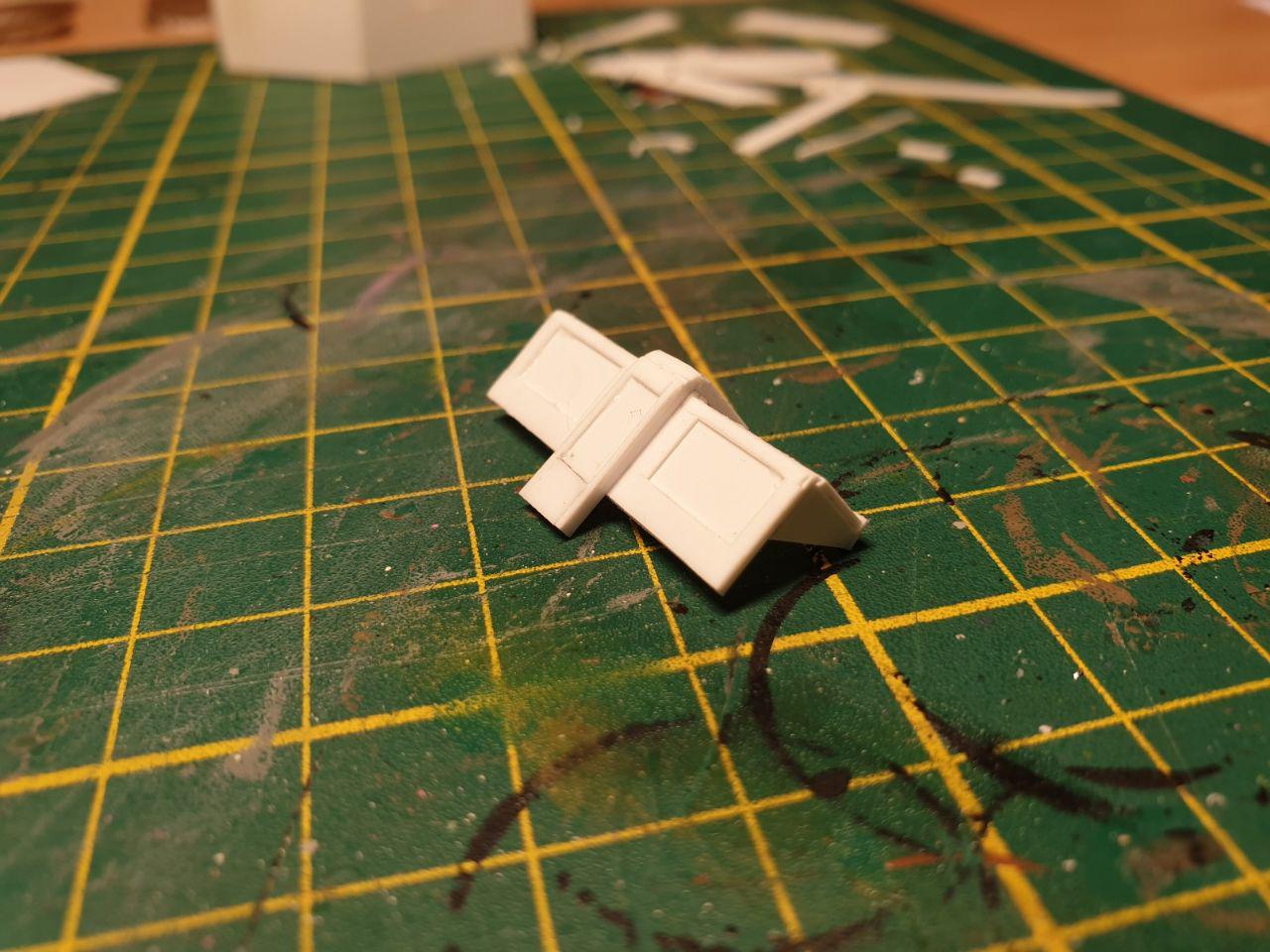

Next was the rear hatch. Obviously I want this hinged. I'm thinking magnets at this point. But I could still go with traditional hinges...

A small amount of progress on the rear hatch was made last night. I ended up using magnets for the hinges, and this works pretty well. Some very careful modification of the bottom of the door and cutting back of the floor of the hull was required to fit in the plastic rod and magnets of the same diameter, but in the end, it works really well. And now I can potentially put a crashed or breached shuttle on the table too, with the door completely blown off ;)
