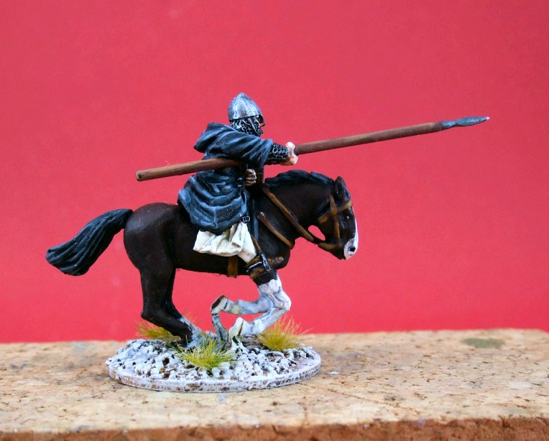

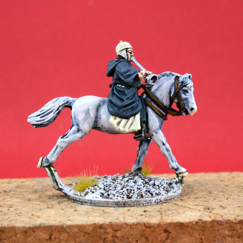

« Reply #8 on: 25 September 2009, 01:42:23 PM »
This is how my horses ended up.
White. The receipt was a basecoat white with a Paynes Grey wipe-off coat. It came out to dark so I applied one acrylic white hilite. I am satisfied.
Chestnut. Dark Umber over Raw Sienna. No further hilites. Worked alright.
Bay. Burnt Umber over Burnt Sienna. Needed a hilite of acrylic burnt sienna (comes out lighter than oil).
Dark Brown: Ivory Black over Van Dyke brown. Needed a acrylic Burnt Umber hilite.
Black. Ivory Black over Paynes Grey. No further hilite. The subtle hilite doesn't come across in the photo but it looks better than you might thing.
I tried this oil method to see if I could speed up horse painting which, as I know some of you agree, is something one would often get done with rather more quickly.
Over all I'd say that the method works. Best for light colours but as you can  tell I feel most of them need further hiliting. The slow drying time is a impractical and doesn't sit well with an impatient guy like me. But the lustre is very nice. The oil method seems to work better with lighter colours. White strips, stars, faces, socks, leggings and mealy noses makes a lot to enhance an otherwise plain paint job.
