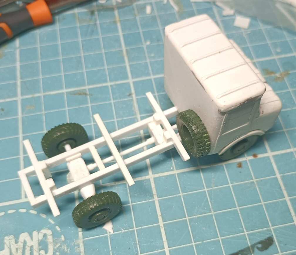

« Reply #78 on: August 10, 2024, 02:08:10 PM »
Biostrip ordered, there are plenty of candidates to experiment with.
So built up a chassis to go with the completed cab. Possibly adding in the prop shafts was a bit enthusiastic.
Put a basic drop side flat bed body on the back - can always find a use for one in scenarios.
Need to sort that cab top with some sprue goo, or maybe just paint it as a bad patch of rust.

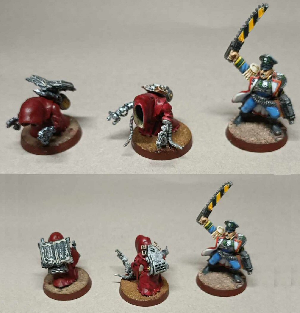

A Cutting / Welding servitor, two magnetised gun servitors, man digging the road and a vehicle refueller.
Of course I got derailed at the painting stage, but eventually I gritted my teeth and had a go.
A major player in the campaign is a Techpriest called HL210. First part of his entourage is two tech servitors, one carries a large technical readout that looks like a book.

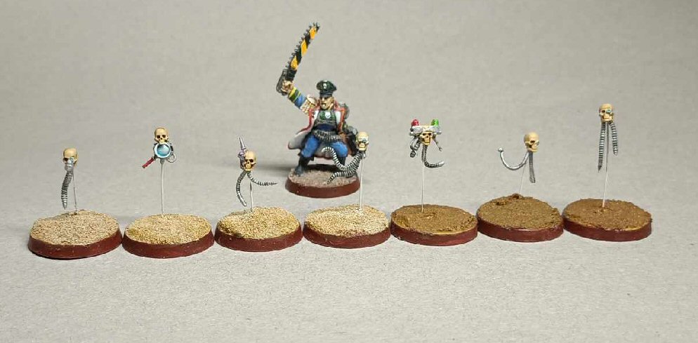

Techpriests also mean servoskulls, so I have started on a small swarm.

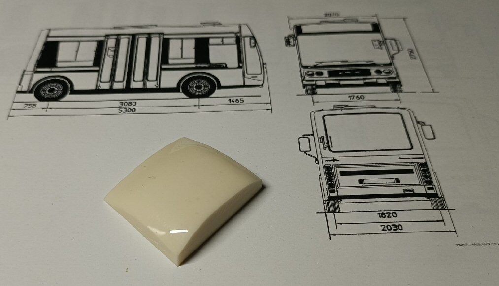

Wanted to make some kind of crew bus for starport scenarios. A tiny vehicle means I wont waste as much if it goes wrong, I can always build bigger & better ones later
Technobus in Italy makes these electric micro buses for city use which fit the part. Drawing is from the ever useful https://www.the-blueprints.com/
Problem was how to do the multi curved windscreen on this type of vehicle. Inspiration came when holding a sauce bottle. After some searching, found one with the correct curvature. Pouring resin into the right part of the bottle, gives a shape with a double curve that will do for windscreens.
Though this does prove I need to get out more...

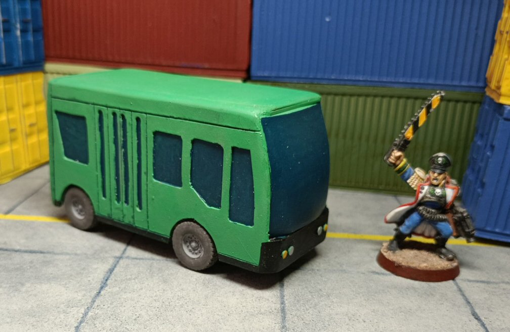

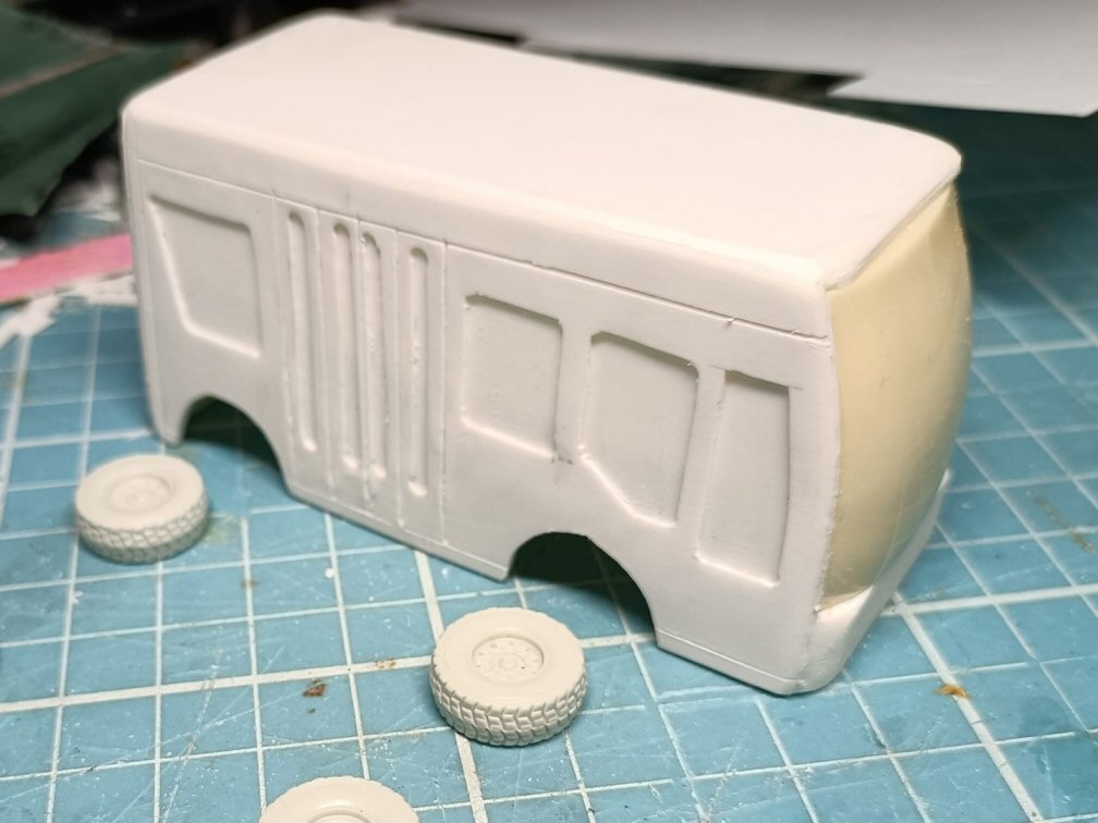

« Reply #84 on: September 15, 2024, 12:32:55 PM »
Well the principle of a resin windscreen appears to work, a bit more sanding and then onwards to cut the window wrap.
Not the best window wrap, not done one in thirty years. But it will do for now, after all this is a  sort of proof of concept model. A bit of scribing improves the look.
Now to undercoat it and get ready for gaming on Tuesday.

« Reply #87 on: September 17, 2024, 01:53:06 PM »
Thank you both, they have been building them in Italy since the 1990s.
It fits many roles; scenario transport, street clutter, objective etc. Also it is only 90mm long -a full size single decker bus would be around 200mm long- so it will not "hog" the table.
Subject to finding suitable bottles, this proves I can scratch build all kinds of SF vehicles with big curved windows.
It is not a hero vehicle and it is needed for tonight, so this will do.
