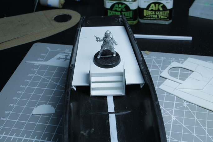

I did the stairs to the cabin and the cabin door itself during the weekend.
I will add a couple of bolts on to the cabin door window frame, but otherwise it's done.
It doesn't look like much was done, but it needed a lot of fiddling to make it fit. It would be easier if I started gluing things in place, but if I do that I can't paint some details, that will be visible, later.

The door into the cabin is very, very nicely done. Is that just freehand styrene cutting or do you have something to help cut that rounded lozenge shape?
This one was freehand, after drawing the shape using a template. I used a ruler for the straight parts, and drilled holes along the curves and cut it in small sections. With 1 mm or thinner plastic card it's not that difficult. It is not that precise either, just doesn't shows on the pics  ;)
The template however was a leftover piece from my 2018 build (the similarly shaped door at the middle of the post), which was cut using a circle cutter like this one. It works if one has the patience to make lots of passings slowly. Mine however is old and the the blade is not that sharp anymore. And because it is a compass style tool, it leaves a hole at the middle, which could be annoying at times. I'm considering getting something like the Dspiae cutter.
