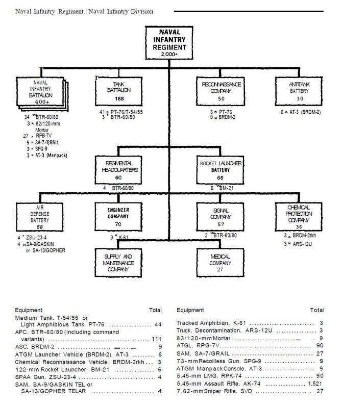

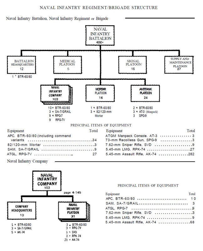

Well I have looked and I simply cannot find anything to support the idea that Naval Infantry platoons had 4 sections. All the information I have is that they were organised and equipped very much like the BTR-equipped Army units (even to later adding a Company support platoon of 2 vehicles), apart obviously from the 1 company per regiment equipped with BMD's as an airborne NI unit, so this is what I'd suggest but if anyone has any other info?
The only reference I have which might be close is the Regt. Recce Company which had a CHQ in BTR, a platoon of 3 BTR (the same as a standard NI platoon) and 2 platoons of 3 BRDM, which replaced the earlier PT-76 equipped Company. Oddly enough, the Russian VDV Recce Company in the Balkans (1990's) used a similar organisation, being equipped with BTR-80's and the 2+5 squad organisation.

Do you have a date for that organisation? I only ask because the information I have suggests that the PT-76 was no.longer used by the mid 80's? Also the T-55's were being replaced by T-72's around the same time? I'll see if I can narrow down the dates on the information I have.
Interesting that you also have the usual 3 squads to a platoon organisation - was the 4 squad (and maxim) a ww2 organisation?

Here is the book from which these tables are taken. Published in 1991.
I think that rearmament to more modern weapons occurred gradually, in different units - at different times.
