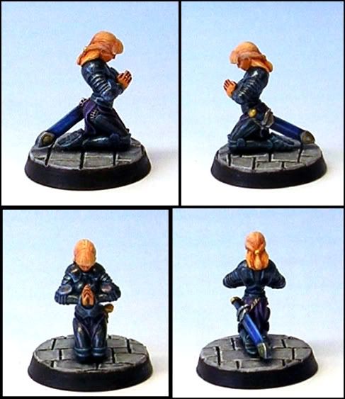

As others have said, several techniques will work.  Mixing ink or acrylic paint with metallics is a tried and trusted technique for painters.
Photo below - old painting - metallic paint mixed with blue acrylic and single wash of blue/black ink.
