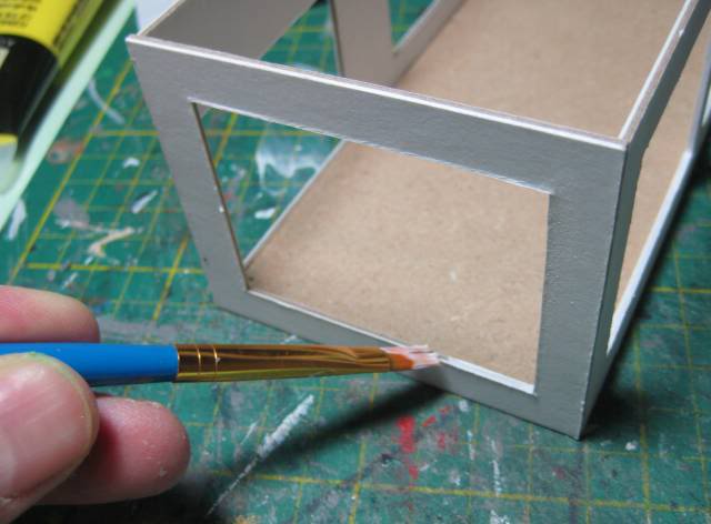

Here is the basic structure made of illustration board with a hardboard base.
Painting the edges of the illustration board for general looks and to seal the edges for durability. It's easiest to do this at this stage.

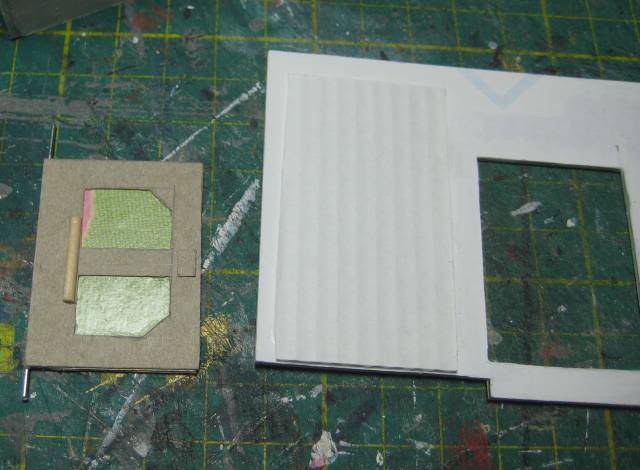

Corrugated cardboard paneling added to close the walls .
Added bamboo skewer trim to hide ugly construction details.
Scratch-built a cereal box cardboard door and the 4th wall. This last wall is added later after the interior is painted and detailed as it is much easier to do it this way.

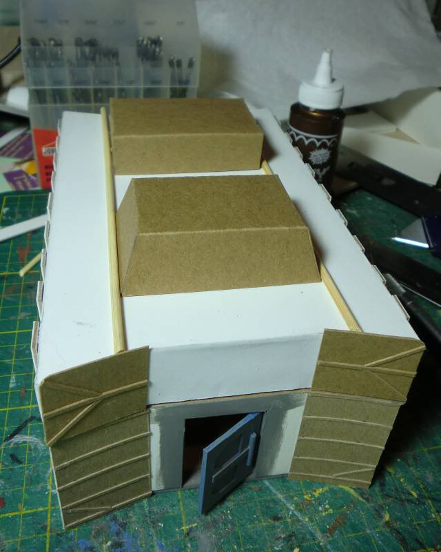

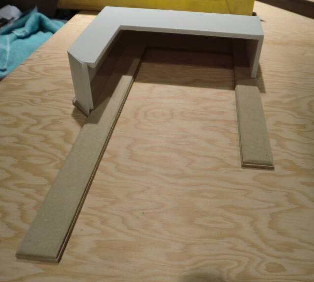

Base made of hardboard cut to proper dimensions. Basic structure made of foamboard.
Basic assembly
Added side supports made of illustration board and edged the exposed foamboard sides with cardstock strips.
Added the bulk of detailing made of cardstock, illustration board and electrical wire. A few more items to add to finish the detailing. Still need to manufacture and add the side trusses. Behind the vehicle entry can be seen the mockup dry run of one of the huts.
Here's a preview on the alley without the concrete pads for the buildings.
Cheers all.

Three huts...self contained structures with different interiors. Foamboard walls, functioning doors, hardboard base and cereal card detailing. Here I'm dry-fitting the floor texture which will only be glued in place once the walls are painted so no paint mess on the floor.
Building the roof structure. Illustration board top glued to insulation foam to bulletproof the structure...two young kids and a cat about. I'll probably use cereal card for the next roof though.
The rest of the insulation foam is covered with card paper. I'll probably use cereal card next time as it does look a bit wavy due to the thinness of the paper but most of that will be covered with detailing so no big deal. Template was planned, drawn, and cutout to make the roof structures from cereal card.
The roof structures get reinforced with whatever scrap pieces are laying about within reach...in this case foam-board.
More detailing added to roof
and to the sides.

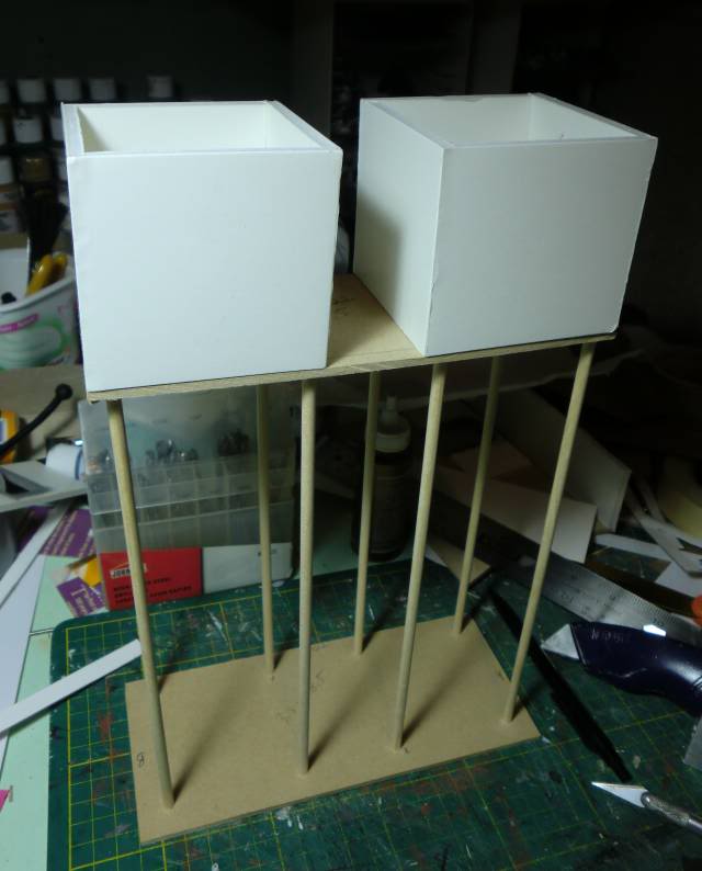

Also in the works is the tower structure located behind the Bar and Grill.

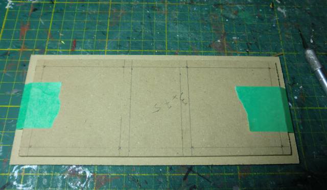

Started with two templates, one slightly smaller than the other. Taped them together so they are centered and labeled them carefully to indicate alignment and orientation.
Next drilled 8  holes for the 3/16 inch dowel support columns. With the two templates taped together when drilling, I'm insured that all the holes will be aligned between the top the bottom plate. That's why labeling the orientation is important. Tip: drilling on a sacrificial block of wood prevents splintering on the bottom piece.
Dry-fitting the structure together. The dowels were cut to length and two simple cube structures were made from foam-board.  I'm not sure what function these  have and to keep maximum flexibility, the cubes were given interior floors so that figures can be placed inside comfortably. That way I can use them as elevated science huts or as simple water tanks.
