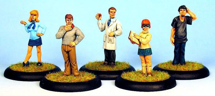

I think the HF mini I am most proud of painting is this one:
That's painted from a black undercoat, by the way.
I still used the GW washes on it too, especially the Ogryn Flesh on his uh... flesh... The good thing about them is that they lose very little of their viscosity and depth of colour if you water them down so you can still use them as normal and retouch the highlights. That's what I've found anyway.

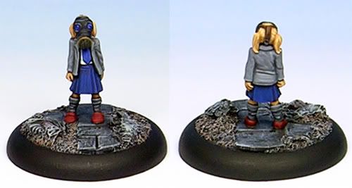

Just to jump on the "Hey, dig my painted Hasslefree figs...!" bandwagon...  :D
These were painted with a process similar to that used by Jolly Bob and Orctrader (thin layers up from a black undercoat).
I find that Hasslefree figures are actually easier to paint than those produced by many other manufacturers, because the quality of the sculpting and the production process is usually so high that you don't need to compensate for sculpting flaws with paint as you do with some other lines (those beady little copplestone eyes, for instance). With a Hasslefree figure you just need to paint what's already there in a straightforward manner and you get better detailed results.
I think that the smaller/sharper brush, thinner paint/more layers and take more time advice you've gotten so far will go a long way towards improving your results.
Be sure and let us see the fruits of your new-and-improved labor.

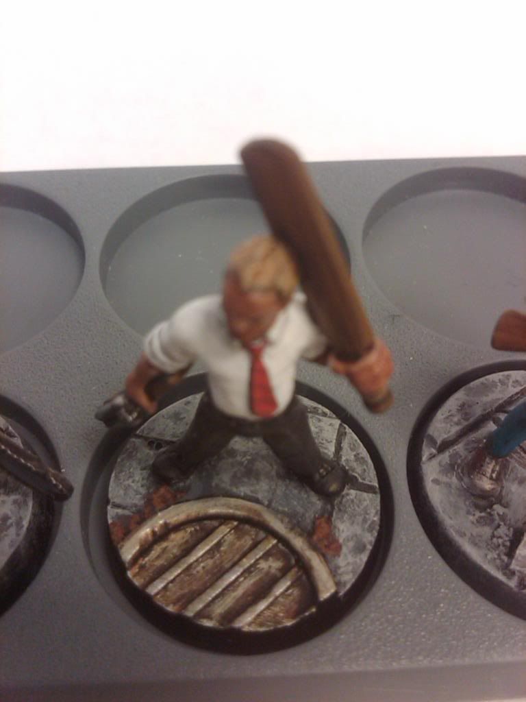

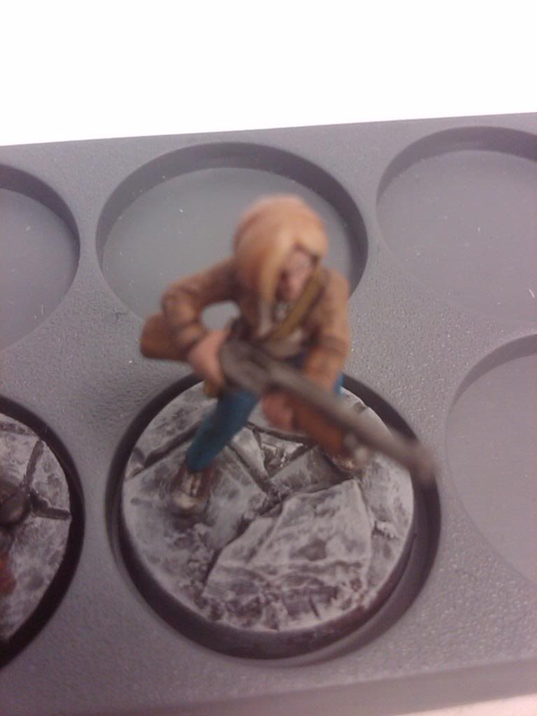

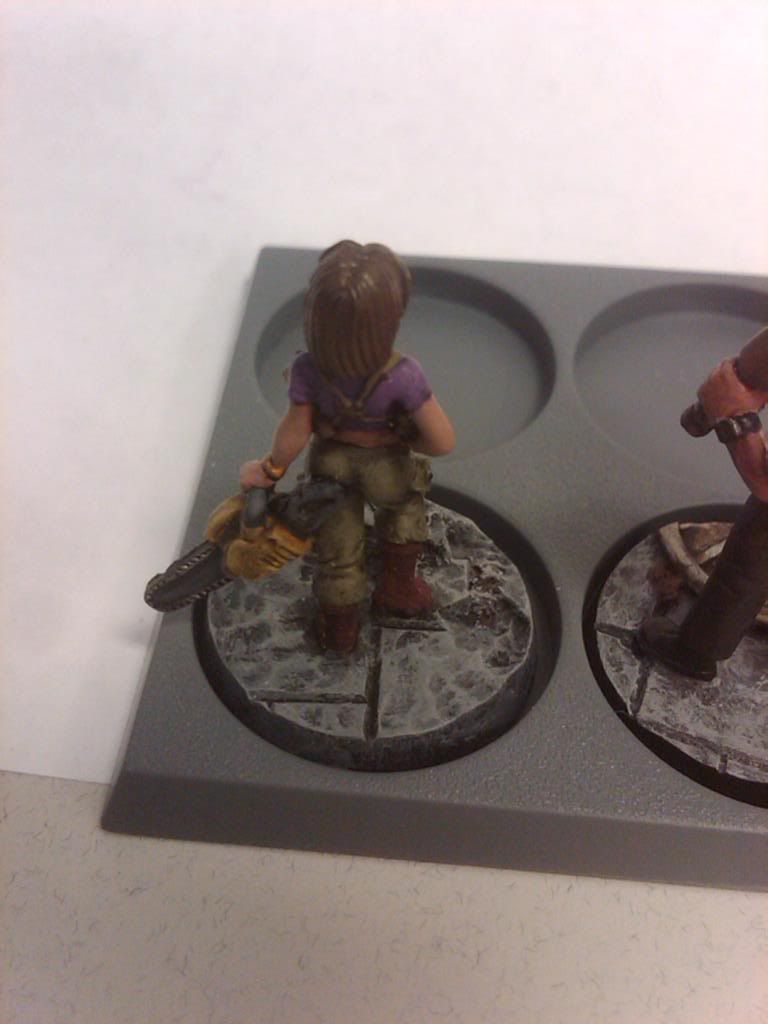

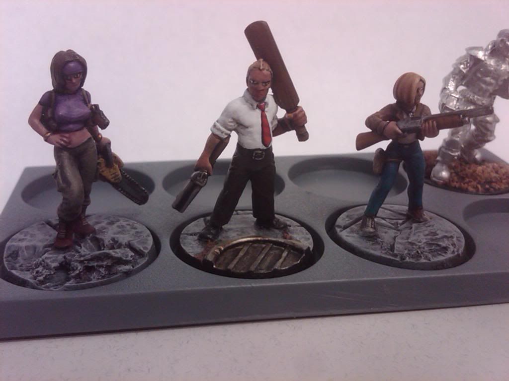

Here's a baseline.  I would love your comments and criticisms.  It would help me learn more.
And sorry about the horrible photos.  I took them with my camera phone in the office while eating lunch in my cube.
Uh oh, how do I re-size the photos?  They're HUGE - sorry!

« Reply #14 on: December 23, 2010, 09:20:20 AM »
Those look like pretty solid paint-jobs Erik, with very nice basing. Well done!
For my (perhaps worthless) two cents:
1. It does look like your paint may be a bit too thick (Your Shaun of the Dead figure's shirt looks like you're losing a little detail due to the thickness for instance). While it can be frustrating to experience the slowdown/delay in results that you get with thinner paints, it's worth it to keep more detail. Work with thinner paint (you shouldn't even get proper coverage with a single layer) and see if that helps you keep more detail.
2. It may be the camera phone photography, but they do look a bit flat- A couple more layers of highlighting with perhaps a few extreme highlights will make them look more dimensional. You don't have to highlight them up to white, just use some lighter shades of the colors you have.
3. The flesh color looks far too pink/red/purple to me. Again, this may be an effect of the photography, but it might also be an effect of too thick a wash, or a wash with the wrong color. I usually find that the various GW-type flesh washes are the wrong shade out-of-the-bottle and you have to add other color elements and thin them significantly to get the proper tone. A browner or more neutral wash color followed by another couple of layers of highlighting with some extreme highlights will make the flesh pop a lot more. A little more shading between the fingers of Shaun's left hand would not go amiss.
4. Kudos to you for doing the eyes (I'm firmly in the "do the eyes" camp). You do have a bit of an oversized fried-egg stare going on though (not surprising if you've been doing a lot of Copplestone). I would consider narrowing the eyes from the top and bottom so that they are more slitted and they follow the natural contours of the sculpt more accurately. You don't need to re-paint them, as your pupil placement looks pretty good and that's always the hardest thing to get right. Just narrow them/shrink them a little from the top and bottom (and sides where necessary) with a dark color and then add your flesh shade over that color until you've covered all but a tiny thin line of the dark color at the top and bottom of the eye (you really don't want the dark color in the corners as it then tends to look like mascara). When doing eyes, I always find that it is better to think in terms of a thin, steely slit, rather than a round dab (even for relatively wide-eyed expressions).
If you find that your eyes are crooked (Shaun's look a little bit uneven), you can also use the narrowing technique to even them up.
Good color choices on these, nice subtle execution on the hair (particularly the women), nice basing. There's really a lot to like with what you've done already on the figures you have.
« Last Edit: December 23, 2010, 09:41:03 AM by Heldrak »
