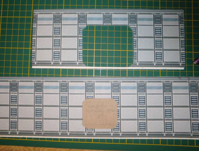

Here I've got the cut foamcore walls, glued the textures on both sides to counterbalance any warping, and let dry overnight under a weighted down board. The station exterior textures are from scratch also.

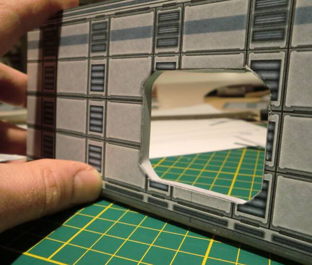

Here I made templates for the standard station doors; single, double, and cargo sized. With sharp, fresh blades I cut out the the doorways. It's important to use fresh blades.

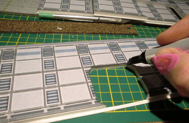

An important step, IMO, in all cardpaper and foamcore builds is to edge the paper and foam core sides to disguise the building materials. This goes a long way in bringing the build to life and make it looked finished. Here I use a neutral gray marker to edge the exposed edges of the paper. I then run and smooth out a bead of tacky glue, and apply a coloured strip of card paper cut to width.

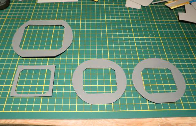

To make the doorways stand out a little and to hide those nasty imperfections, using the door templates I cutout and painted cereal card to make frames for the doorways. The interior frames have spacers so doors can be slid into place. Because I'm using printed textures, almost all painting must be done to the pieces prior to adding to the build. I build a small sub-unit, paint it, then glue it in place.

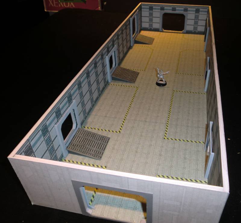

The assembled dock. I've added ramps leading to the docking ports/umbilical corridors. It's still a WIP; need to edge the top foamcore, add warning labels, maintenance hatches, display panels, cargo loaders, design and make doors, etc.

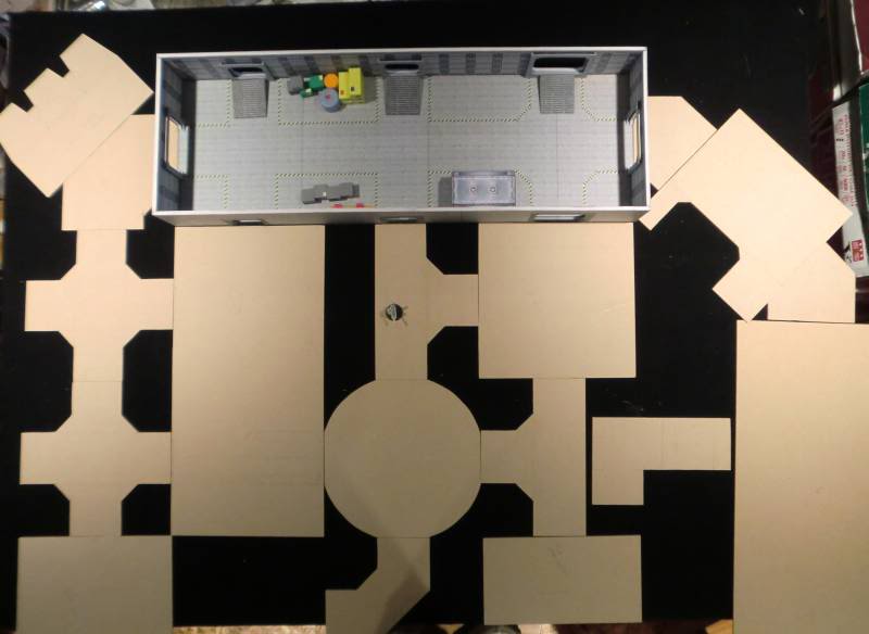

Then I got carried away cutting out some of the other template bases (about half are in the photos), mostly for the docks level, everything from airlocks, to pod bays, to corridors, to high security labs, to habitat sections.
